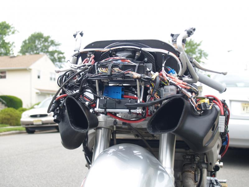

In a sense yo're right about the ground. It's the ground not just for the starter but also for the entire engine. :beerchug:
My wirring is a bit different so I don't have the OE setup anymore.:laugh:
