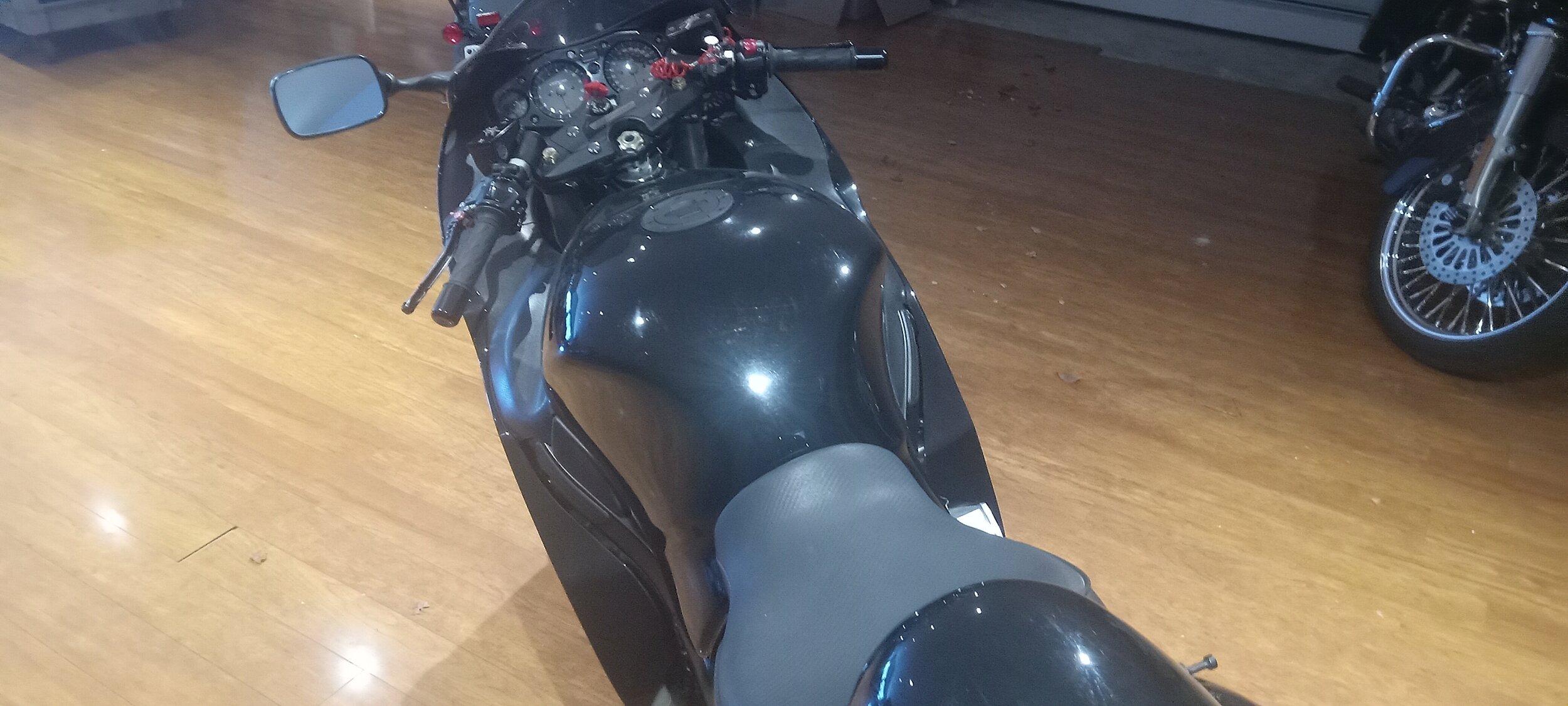

Sixpack, always enjoy seeing your insightful comments. Yep all of that is done except the lockwire. All major weigh reduction minus a couple minor things are done. Still waiting for someone to post some CF wheels for sale but it has a set of R1 now. Waiting for a cera-carbon sprocket discount but also have a couple aluminum back ups.
Some of my "ideas" have been tested and argued 100 times on here but I'm going in solo so I've gotta come prepared and correct.
