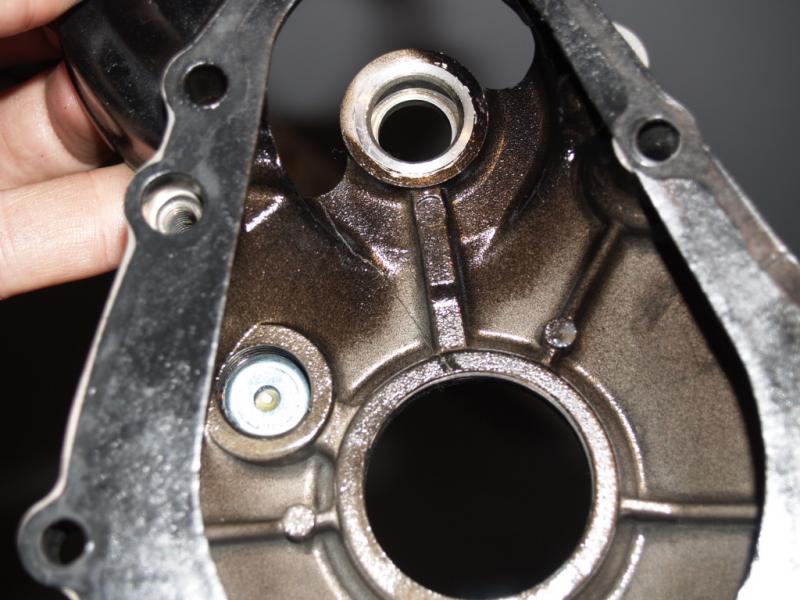

Billet starter cover with support on end
Just in case.
Buy Now: Hayabusa STATOR COVER, Case Cover, Yana Shiki, Epic, Vortex | Pashnit Moto

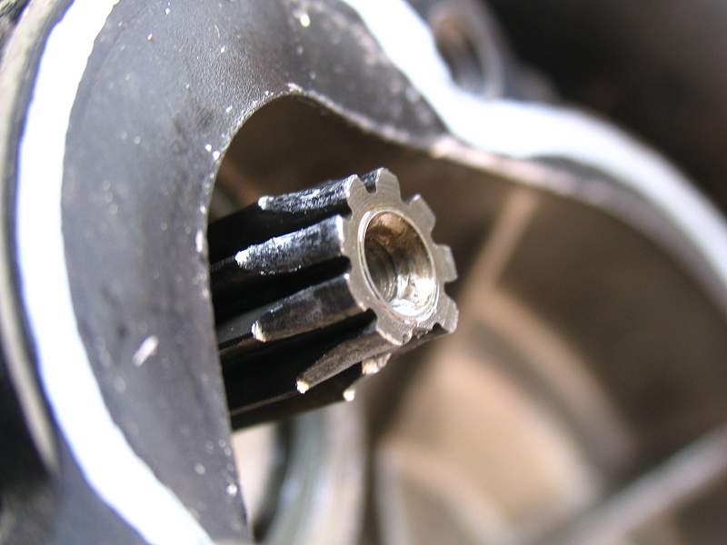

I replaced my starter on my '00. Had some issues.

Wow thats some wear there pashnit.That looks like your starter motor right?
The pinion gear that sticks out from the starter. Replaced the starter with a Ricks (we can get those to sell too), and then ordered the replacement gear from Bike Bandit which is good for little internal bits like that.

Hmmm thats a clearer picture.:thumbsup:.I am curious why not stock instead of Ricks?Any link to it?:beerchug:

Make sure you get yourself a case saver (Ti ring). It saved my case :bowdown:.
I ended up replacing the cover and installing Brock's pins. If I find some '03 or newer starter gears then I replace evrything with that and swap to the newer cover.
