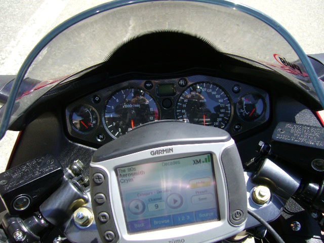

Of course, a Garmin Zumo has a complete motorcycle dashboard display and is dead accurate....I don't even look at the OEM panel anymore!
