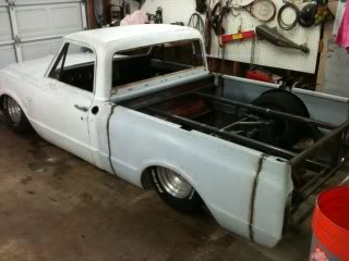

If you rub a small wheel/tire combo you may be able to lay frame without cutting the bed floor. You can get it really close on 20s
