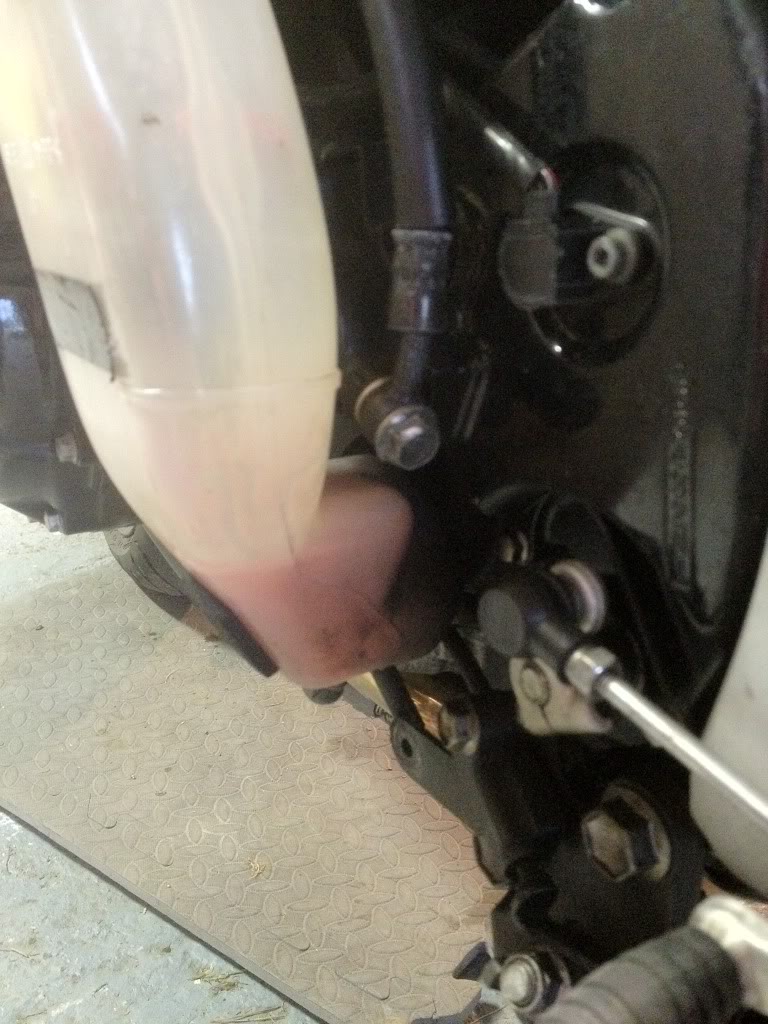

Here is where the level is at when cold
After a warming up and a hard blast this is where it goes
