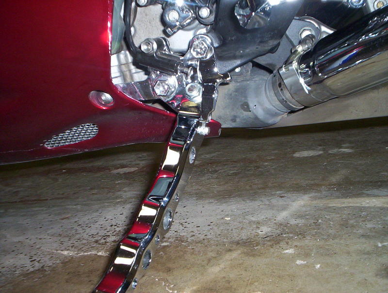

I had the same problem,
Took and drilled and tapped a hole in the Kickstand ran a very small bolt in the hole to hold the stand off the exhaust.
Funny thing, when I bought my chrome Tribal stand it came with the Bolt in the Stand

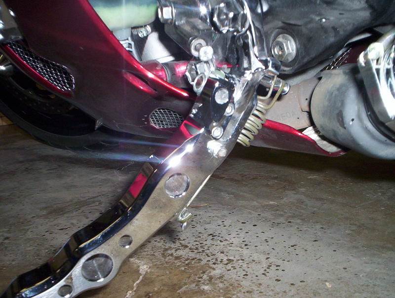

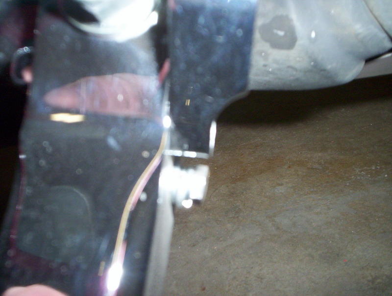

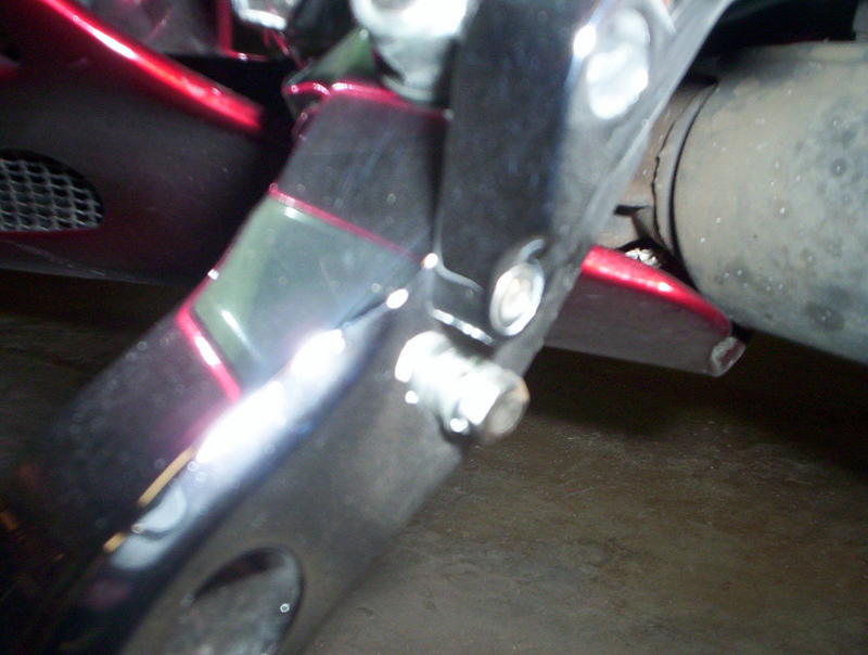

you will get an "IN FOCUS" image if you back up from the subject matter a bit.. if you have too much other stuff in the shot when done, just crop it.. "fuzzygraphs" are hard to decipher..
Hope these look better.
