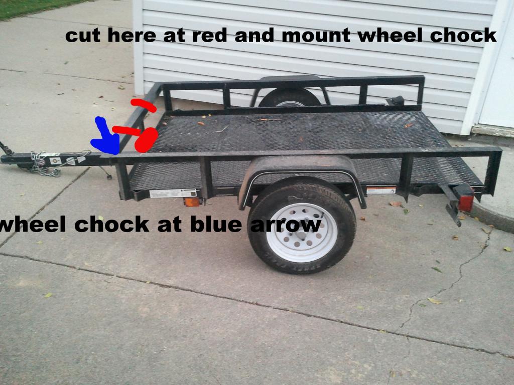

I came across this little 4x6 trailer before I bought my bike to use to haul stuff like yard waste and whatever behind the jeep. Well I'm thinking I would like to trailer the bike up the the black hills so I can have both the jeep and the bike to play on. I'm thinking about cutting the front rail and putting a wheel chock of some kind up there. It seems like a good solid trailer. I also have some 17" wheel's from my jeep with some 31" tall tires I'd like to mount on it also.
Any of you guys/gals do anything like this or would I be better off selling it and buying a bigger trailer, which i'd rather not do. Lets see what you've done and yes I've looked at pretty much every trailer in this section :)

Mount one of these to the front of the trailer using some good strong hardware and loctite. Add a pair of good tie down points at the front corners of the trailer. Canyon dancer for the bars, couple extra straps for security on the back and you should be good to go. We set up a similar trailer in this fashion for a buddies 900rr. Plenty of miles with no issues. Bigger wheels and tires will help stability on the highway, not sure about 17s and 31s on such a small trailer though! Another friend just made the trip to TX2k14 with his R1 using a similar trailer behind a BMW sedan and had no issues.
that's the wheel chock I was looking at. Planning on putting a C channel down the middle for a little added weight and solid track for the tires to run down.
Any recommendations on tires/wheels. I had these off the jeep but I have no clue how well they would work. Would the stock tires/wheels work ok? Maybe just make sure they are greased good and air pressure is good?

I'll cut the front railing and mount the chock on the tongue which will extend it the foot needed and add some bracing to make sure its solid. It has a pretty long tongue so I think it will work. I'll also watch craigslist for a bigger on in the mean time.

Heres some pictures of the bike next to the trailer, to give some ideas of how it would fit. Would possibly do a wood floor or maybe just a flat plate down the center and of course bracing where ever needed for mounting points.
