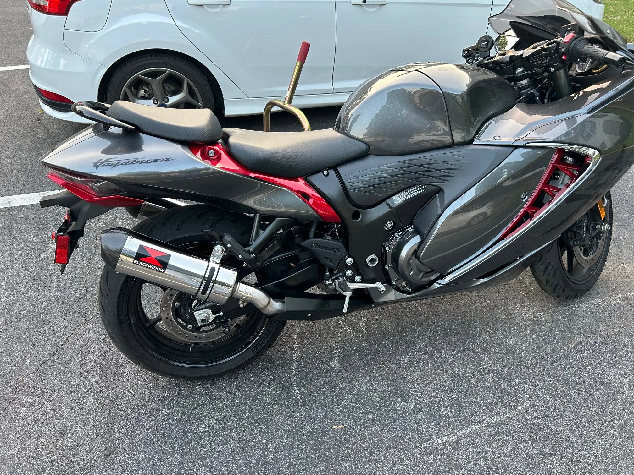

overall pretty good with one exception.
for starters..
initial quality seems good
not missing anything and packaged well
very complete, even came with a container of sealant
instructions were actually a pdf which is fine, emailed to you after the order is processed i think
only hangup was.. the right side didnt line up that well. once i loose-fit the entire right side and then just hitched everything up, the whole muffler needs to be a good half inch higher. it simply did not line up with the hole in the rear peg where the exhaust mounts in the OEM location. i had to forcibly lift upward with at least 30lb of force to just pull the thing upward to where i could get the bolt through there, and get everything fastened up.
no problems at all with left side.
DB killers/baffles included, pre-installed. ran them for a few days then removed, tricky to get bolts out. they come unscrewed then immediately fall down into the interior of the end cap. i needed a paperclip with one end bent into a small fishhook to eventually dig them out. no issues after that. generally sound better with the baffles out.
for something like 530 USD shipped, cant knock it. bit of weight savings which is cool i guess, noticeably lighter than the stock mufflers which each contain a cat converter (euro5 compliance, probly).
shipping was handled well but was UPS, which i hate, i'll pay for fedex all day. UPS is the fkn worst. they honestly do everything worse than the other shippers.
before installing i ceramic coated just the cans with gtechniq C5, the stuff designed for wheels and brake calipers and such. just a slipon so no tune really needed, factory headers are still on there. once THOSE are replaced yeah i'll get a tune.
..no, theres nothing wrong with my tire, just has some white dusty whatever all over it from the floor of my garage. in fact im probably getting the pirellis since it'll be that time, soon.
