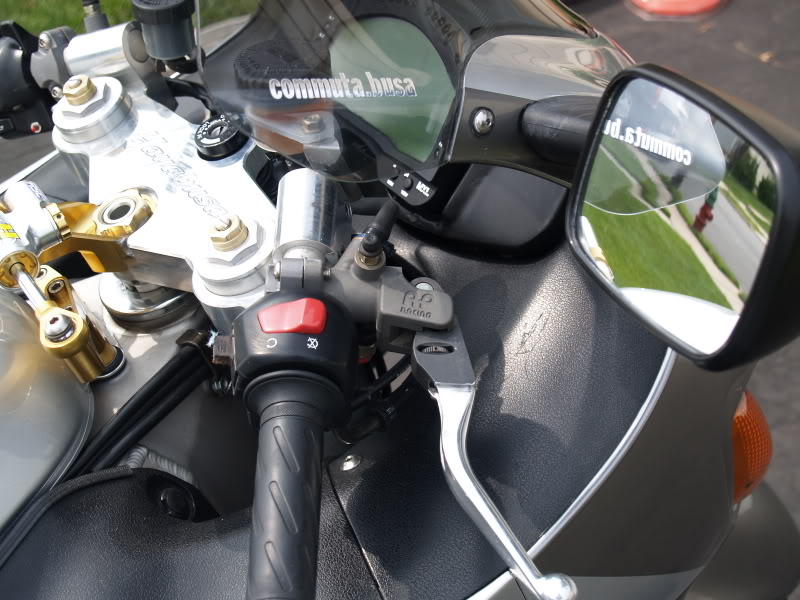

have you gone to a different pad yet? What about your lines? I switched to radial levers and the "feel" is amazing.

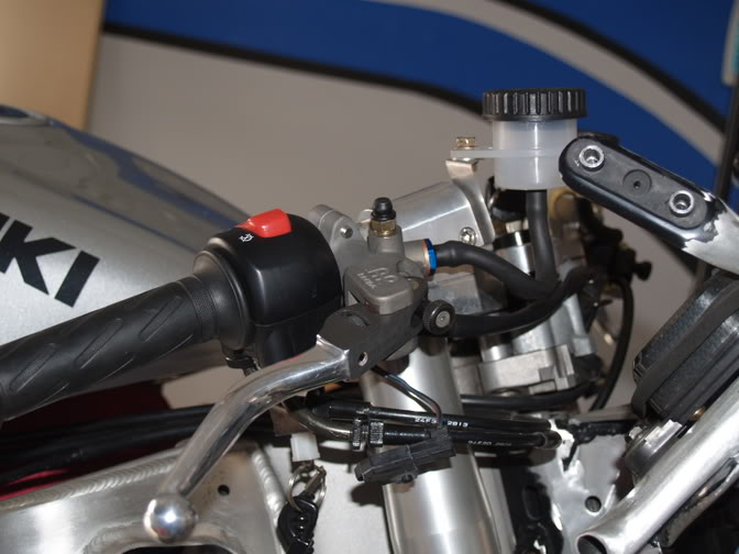

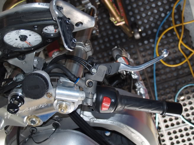

You can take it as far as you want to go. I have changed to Galfer Wave rotors, Galfer race pads, Brembo Radial master combined with Goodridge lines. Two finger braking on Road Atlanta's back straight getting ready for turn 10a.
