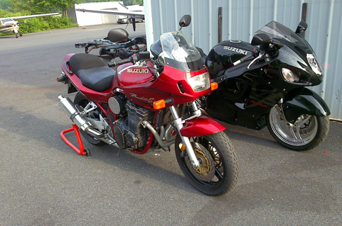

I bought a '98 Bandit new, rode it a few thousand miles and put a Mr. Turbo kit on it, and passed it along to my "child" a few years ago .. He's been riding it in California .. Odometer shows 95,000 miles and it still runs just fine with the only mods to the engine being a .060 spacer, under the cylinder, re-degreeing the stock cams to 105-105, and a lock up clutch .. And methanol injection too .. Made 154 @ 8lbs .. Great bike ..

Very nice. Should put some pics in and discuss a bit more. Sounds like an awesome build. Thanks for post.

This is a very nice looking bike. What we love about our turbo bandit is the addition of the Healtech quickshifter that works up and down shifting that just completely changes this bike into a demon on country roads. You have made this bike look good without having to strip it. Love to see some more pics of the turbo setup.

Uses a Rayjay (aircraft) F40 turbo in a draw thru configuration with a Mikuni HSR 42 mounted behind the engine .. Not an ideal turbo, or an ideal arrangement, but still gets a reliable 40 mpg on a trip, with a/f indicating 14.0 - 1 in cruise .. The only really downside to the draw thru is cold start where you get cold fuel puddling up in the turbo .. Cleans up after the first miles or two .. You learn how to cold start it and ride it away, and it's not really bad at all ..
