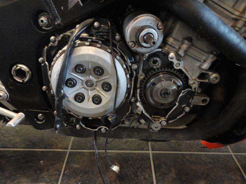

i just got the bike and idk what its missing. i know i need a clutch cover and starter cover. does any one know wat i need to do to fix it?
did want to piggy back off your thread im new and i dont know how to make my own
I know its cool man. I was more concerned that you get a dedicated thread so you get help you need cause that does not look bueno lol and i do not know what you are missing to help :laugh:
