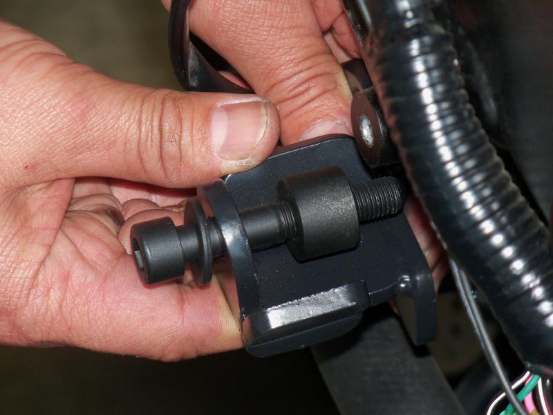

So I decided to spend the $15 or so dollars on some knock off T-rex sliders. They came in today and I'm a little puzzled as to how they mount up. I googled it and found a very helpfull page with pics and all. The one thing that was not shown however was where the heck the little aluminum bushings go. Looking at a pic of the T-rex's, the kit is the same but has two aluminum bushings rather than one. My bike is in the shop this week so I don' have it to dry fit up yet. I'm just trying figure it all out for when I get her back.
On a side note, these things are actually very good quality for being so darn cheap. I'm a machinist and a welder and I can honestly say that these things are welded like a friggin tank and are robust enough to satisfy even the most skeptical of folks.
Can't find my camera cable... It's always something.

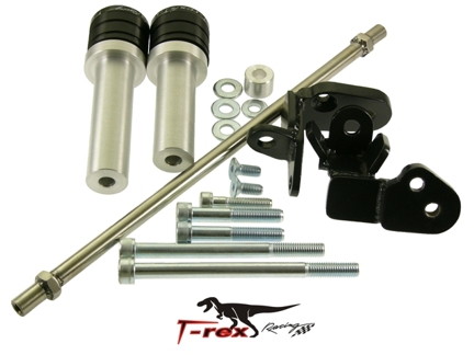

Anyway, in this pic of the T-rex sliders you can see the bushing I'm talking about by the washers. My China kit came with two, one slightly larger than the other. This is the best I can do till I find my camera cable.

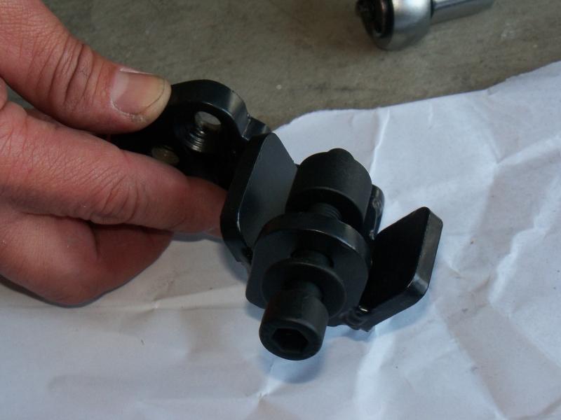

that "bushing" is a spacer for use with the shorter stem. found a pic, hope this helps
