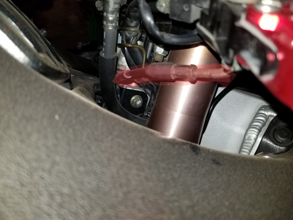

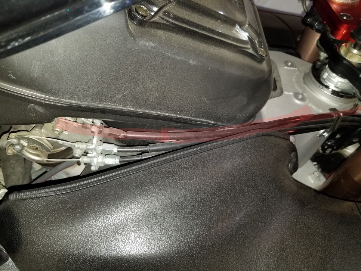

as you can see in the 2nd pic, the cable goes around the steering column and then joins with the throttle linkage. Until I get an answer, I'll prob reroute the linage between the tank and the triple clamp. The choke/high speed throttle adjustment has bee the source of my woes.

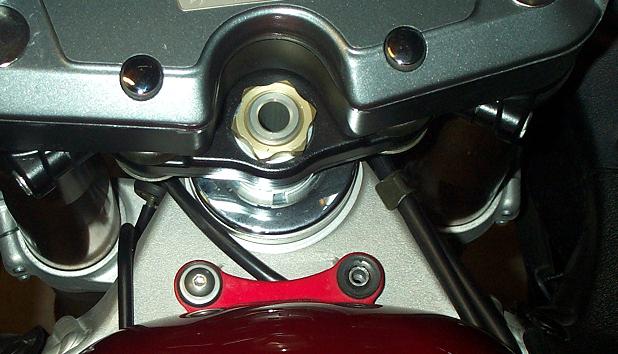

I hope thos helps but it wraps around the ignition.

Looks like the routing is correct, I think you just need to adjust the cable at the throttle bodies and give it a few mm of slack/free play.
Thanks. JeffSyh, you went WAY out of your way to take those pics! Thank you! The one diff is I rerouted behind the ignition wires. That seems like a shorter path, but not enough to fix the problem. I'll play with the adjustment. My adjustment to give more slack for the cable actually shortens the housing. Maybe I'm adjusting in the wrong direction. I could try buying a new cable, but I fear I'll be in the same predicament.

It turns out that my bike has a lowering kit (thanks "Hayabusa Wannabe") and although the instructions say it doesn't alter cable routing ... It does in my case. I'll go with the standard reroute option that people have already covered with handlebar riser kits.
