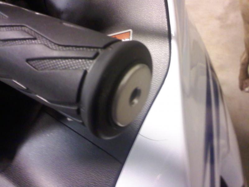

Real Newb here and didnt know exactly where to post..got an 09 Busa White and I'm starting with the light stuff first. Just ordered some chrome Kanji bar ends and I'm not sure how to install them. Got the left one on just fine but when I installed the right one I had a problem with the throttle. When I tighten down the bar end it also tightens the throttle and makes it stick. help plse. I'm sure this can't be that complicated.

Post a picture of it for us to see. Welcome to the oRg! You might need a spacer to keep the bar end off of the grip. Is it hitting the grip or throttle sleeve?
Thank you all for the welcome! Sure nice to see responsive forums members...will do my part when I know what the heck I'm talking about, lmao. Here is a pic without the chrome end and with it on loosely....
Try sliding the grip up on the throttle sleeve away from the bar end. It will take a little pressure, just dont twist it too much. It looks like in the picture it only needs a smidgen of clearance. Either that, or add very thin washer between the bar end and bar. But I you shouldnt need it.
Thanks alot! I tried the first method but it wasnt flying....I finally dug around in my toolbox and found this small washer....and problem solved. The Bar end doesnt sit up tight against the throttle but it still looks good :bowdown:
