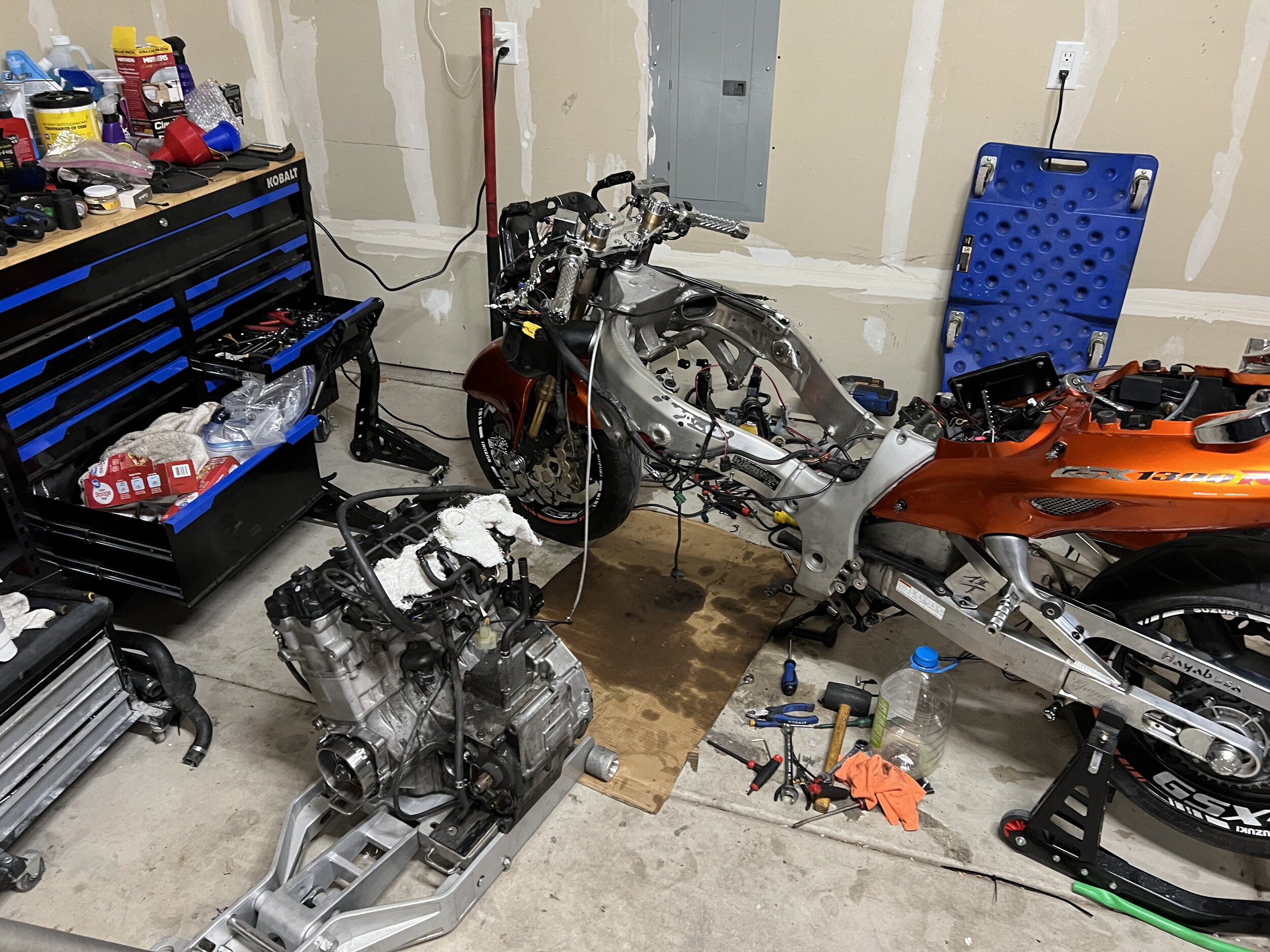

I recently rebuilt my clutch slave cylinder and master cylinder just as a precaution and even bought braided hoses. I also replaced the clutch and plates along with the oil. While out riding the bike felt like it was slipping and eventually stop engaging all together. I eventually was able to get bike on side of road and saw my oil boiling in sight glass. I tried several times to engage the clutch to no avail. I allowed the bike to cool down and tried and got it to engage I. 1st -2nd gear but then it did a God awful grind when attempting to put in any higher gear. I just pulled the engine and split the cases and found the 3rd-4th gear dogs chipped. What do you think caused the issue in the first place that wouldn’t allow me to have power? It is a 2005 Suzuki Hayabusa with 40000 mi on the odometer.
Did you bleed the line and have good lever pressure/clutch engagement before you left on the ride?
You should be able to shift up and down without using the clutch(only using clutch in 1st from a stop), letting off the throttle, and applying light pressure on the shifter, but, a normal shift when the clutch should have engaged, but didnt, would cause a rough shift, and chipped the gears.
Did you vacuum bleed the clutch line?
It sounds to me like it had air in the line, not just tiny bubbles, but a pocket.
Air will move towards the end of the line, and you will lose pressure in the process.
Yes it had a good hard clutch. I rode it in to work a couple days prior to this happening. It’s possible that there was a little air in the lines though. I tried the vacuum bleeding but I will re-bleed the system after I replace the transmission gear and I also purchased the factory pro evo s92 shift star. I plan on replacing the oil pump and rebuilding water pump since I am already this far into it. I may look into rebuilding the clutch master cylinder again as I did notice a little drippage every now and then at the master cylinder.
If you had a noticeable drip at the master cylinder, then that is what happened, air got into the system until you lost pressure, then that clutchless shift chipped the gear.
Thanks! Will be putting it all back together once the parts arrive on Saturday. I have it all disassembled currently and look forward to putting it all back together…..with new parts in these hard to get to areas as well.
