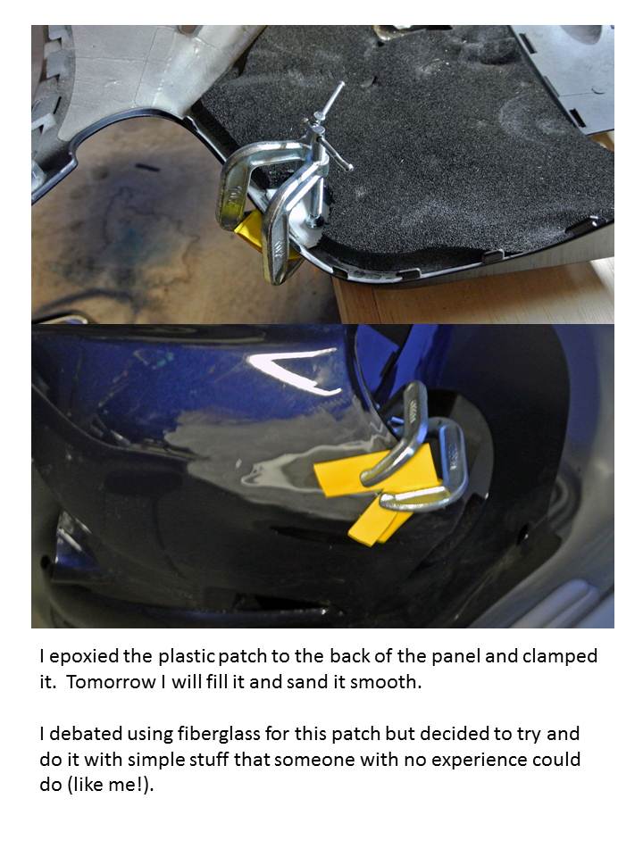

Since you are willing to pay for a custom paint job, why not buy an oem fairing same side of any color? A custom paint job is going to be a lot of money. I paint and with the cost of paint as high as it is, to do a custom paint job, candy, pearl, etc. you have to be willing and able to charge the customer top $. I wasn't able to do that to people and so I never made ANY money. Some jobs required 5 hours or more of wet sanding and buffing and that's just small parts of a motorcycle with expensive as hell sandpaper. That being said, any plastic weld and or repair I attempted failed over time. I hate ABS however I can do a fiberglass layup like a whiz. I have rebuilt entire boat internals, stringers, etc, and I cannot make an ABS weld hold smh
My patch hasn't failed in 8 years. Depending on the crack it can be fixed in the garage DIY easily. A new fairing isn't cheap and you can get a Busa painted for $1200, especially if you send them the plastic off the bike. Maybe not show quality but a good respectable job.
