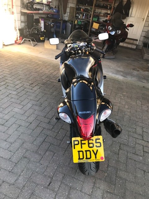

I have just got bike and did lots of research on handlebar risers, so being tight I went in search of DIY method, so went to fasteners shop and purchased extended HT bolts and SSteel washers, result below. Went out test road them bars raised by one inch not fouling fairing or screen. Job done Dave
Didn't know they had Home Depots on the other side of the pond! Honestly, that does not look good and is actually not smart. Neither are Soupy's dumba** spacers, imho. Both of them leave the handlebar "holder" flexing on the outsides, over the fork tubes. Does that even look safe to you? The best and safest setup we have seen so far are the Genmar risers . . .

They sell a lot of things that are not safe, like Hayabusas. Look at that top triple tree (what is actually the handlebar clamp) . . . if you lean down hard enough, you can at the very least bend - if not snap - the entire end of that part that holds the bars on each side. I am sure any roadracer in his right mind would not want the handlebars flexing or possibly worse . . . good luck with that.
Since they are stacked washers, and not solid, the top plate has more room to flex and shift too. Especially if the bolts become loose.
Thanks for you replies I am now adapting support for each end to support handlebar ends( have spacers that fit on top of fork stem, will post when done for opinions/ advice I think you are all right though.

Good evening all , you'll be glad to know I have now aborted this project and bars are back in normal position, I thought it was just to dangerous and I value life. Thanks for the support Dave
