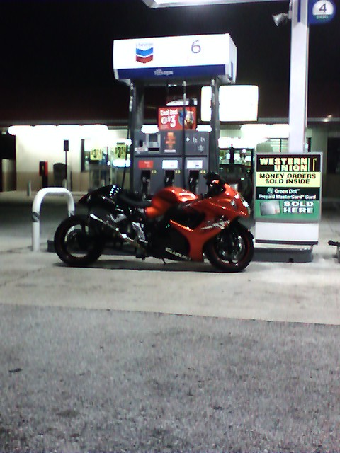

Follow this link (www.picturetrail.com/iowadivers) and you will find a series of pics of my K8 including many from the dissassembly/reassembly process... unfortunatly I have not taken any pics of the totally finished bike except one from my cell phone (its on there) that didn't come out too well. I will post more soon. Here are a couple things I learned while doing this that you may benefit from if you are planning to do this to your K8.
