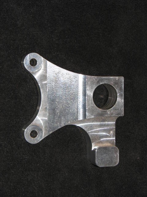

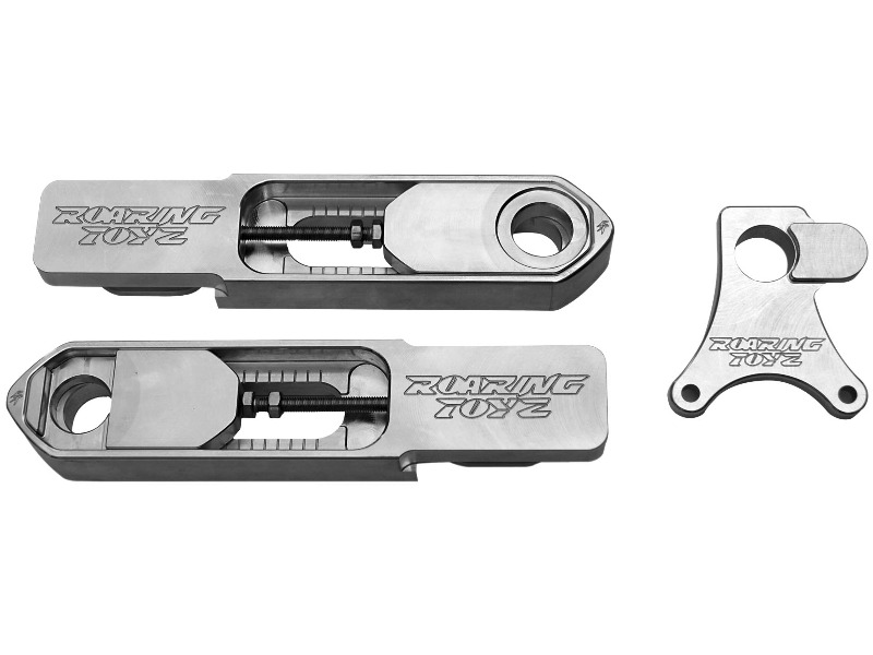

Ok I have a bracket that came with it, Just didn't have a extended brake line (which i can get np). here is same kit i got but mine are the black ones.
Does this bracket move the caliper on top? I hear people talking about rotating the caliper. Does this bracket move the caliper to where I use the oem torque arm?
Starting to understand this
With that bracket, you do not use the torque arm. It puts the caliper in the stock position, but that little nub fits into the slot on the extentions.
As mentioned above, you do not need a new brake line, unless you just want to replace it. Loosen the banjo on the stock line and rotate it around to where it points out the back.
ahh ok so the bracket strengthens the caliper, which elimanates the torque arm? I'm ordering a clymer book today to help me with everything too
The arm anchors the caliper to the arm, so it does not spin when you apply the brakes. You don't use the stock brake (Torque) arm anymore. They both serve the same purpose, but you cannot use the type you rec'd with your extensions on a stock arm because the axle slot is not long enough.
