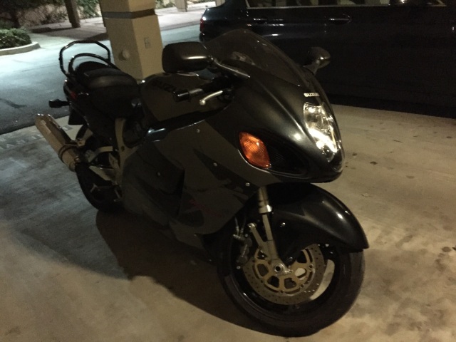

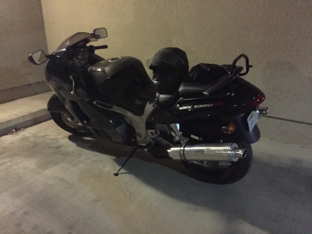

After several months and a bike later I finall brought the 1999 I have been looking at home.
I posted on here about it several months ago and it sold and quickly returned to the dealer.
Sat for a long time waiting for a fuel tank etc and it was brought back to life about a month ago. The idea of having the non governed , first year model grew on me and finally I wasnt going to let it go.
Sold my recently acquired Vrod and grabbed it...
I only have a couple poor phone pics as of yet (im battling the flu and just got it home and went back to bed.)
After all the dust settled It has brand new Michelin pilot powers,new pump, new filter, fuel hoses, rollover valve etc. fresh service.. 5800 miles on it... Wound up about 4500 OTD...
Old school 2-Bros boltons and a center stand...
I found a mismatched black hump to put on it till I find the Saturn Metallic one.
Thanks!
I cant wait to get back on my feet and get a good ride in....
First mod on the list I think will be the starter upgrade so I feel better.
Been commuting in the cage for too long now.
