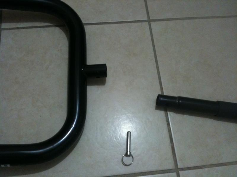

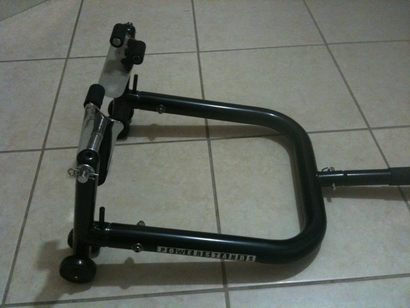

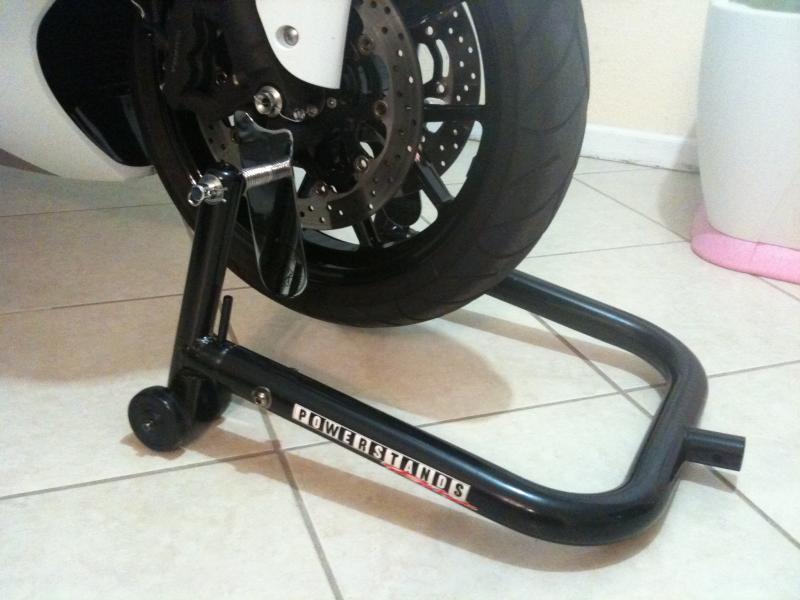

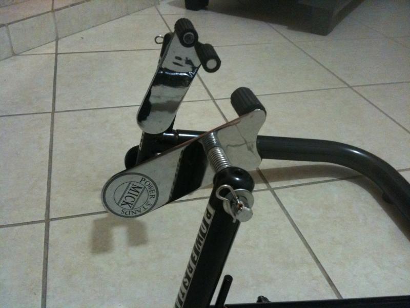

Heres a few pics for you.
Nice chrome lifters.
Solid black tubing.
Detach handle.
Lifts it good and high so you can get wheel out.
Little tubes sticking up are axle holders also
At 129 direct or 119 from distributers its a good price.
I looked a pitbull in cycle world they did not seem as heavy duty.
Also the rear I had was power stand so now they match.
You know how guys are.
Things must match...

I hang my bikes from overhead hoist for tire changes, afraid to jack them, & don't want to remove the fairing to get under the headers, getting hooked on the stand for cleaning and lubrication/storage. Stands are real nice for stability. Just don't want anything thats not "Busa board proven" :laugh:.

I leave bike on both stands sometimes.
Its very very stable.
An idiot would have to want to push it over really hard for it to do so.
