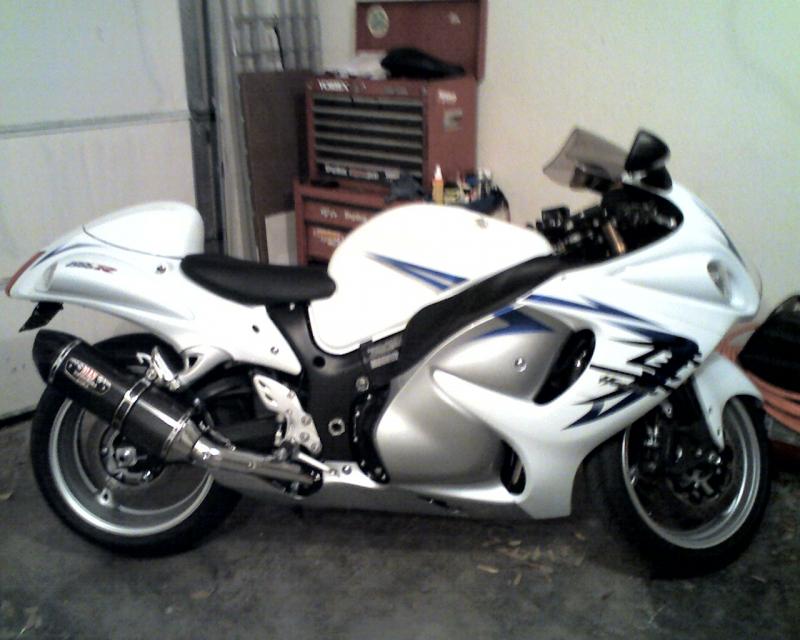

put the r77 yosh 4-1 on my 09 and pair valve block off, and made a big diff. in the way the bike runs. sounds realy cool but not very loud:smad:
