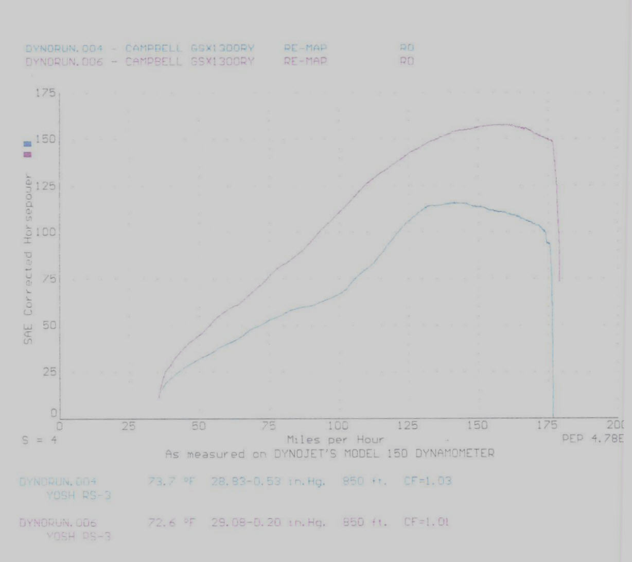

I use to have a 2001 and found out that my cam chain was off a tooth. You can see the before and after in my dyno run. They did a recall on it before I took delivery so I never noticed missing the missing HP but to me it ran great.
