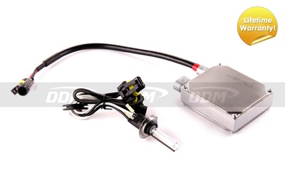

Trying to upgrade my 05 headlights….. I hate that I can’t see 10 ft I’m front of me without my brights on.. any suggestions so I don’t spend $100 on a bulb and it doesn’t work?
The DDM Tuning Ultra HID kit is built on our proven technology to bring you an even more stable HID Kit with increased longevity and performance. The ballasts have been improved to require less current on startup to protect the factory wiring and to extend the life of the bulb by not forcing too...

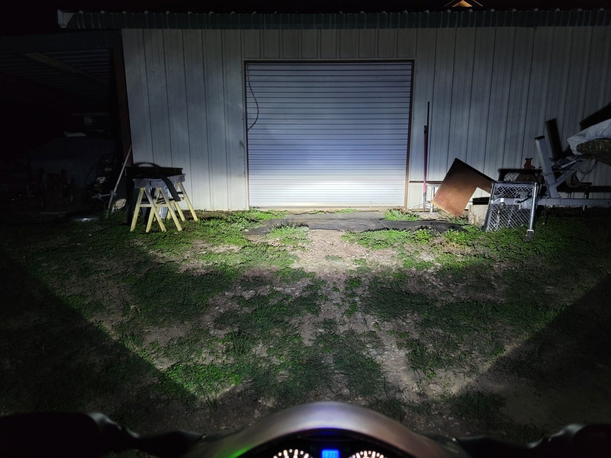

The Gen 1 headlights are so so.
The low beam from the factory is way low. (WAY LOW)
Pull off the screen, the top inner dash panels and the gauge cluster go for a ride at night (duh...) and adjust the low upwards.
