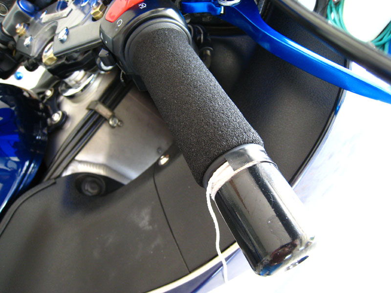

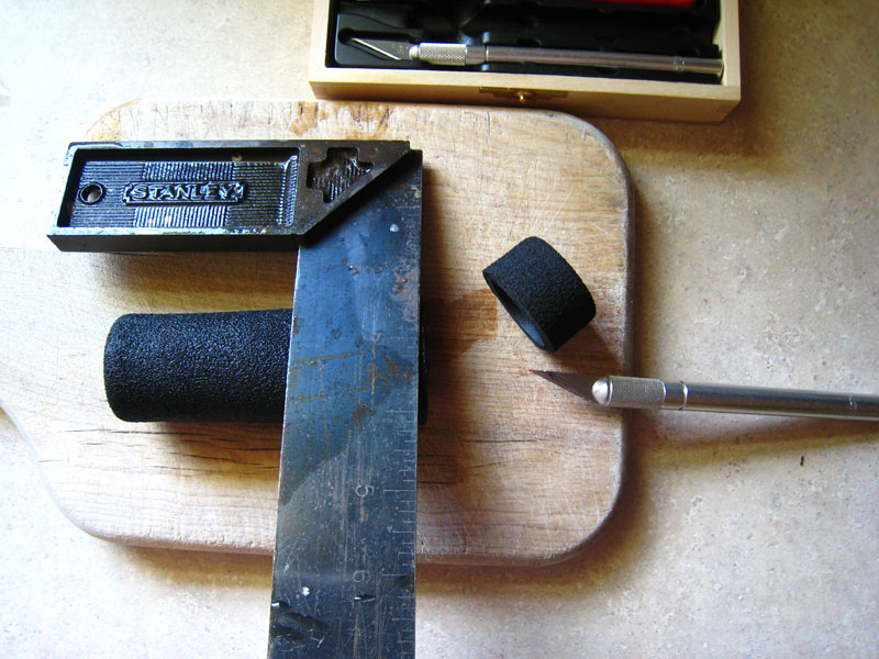

Got my Grip Puppies installed. Actual installation took about 10 seconds each side. Most of the time was spent in prep and cleaning up the mess. As you can see, I wound nylon string in the throttle gap to keep soapy water from getting into it. I taped the string down with a narrow piece of electrical tape I cut. I used softsoap and water for lube and soaked the Puppies for a few minutes in hot tap water. When I installed them, I used a handkerchief to push them on over the end caps. Without the handkerchief, your hands will slip endlessly on the soapy lube..!! You'll notice I cut the Puppies off at 4 1/4 inch, with a straight edge and Exacto knife. This gives a neater cut than using scissors.
I LOVE my Grip Puppies. No more hands going numb..!! :thumbsup:
