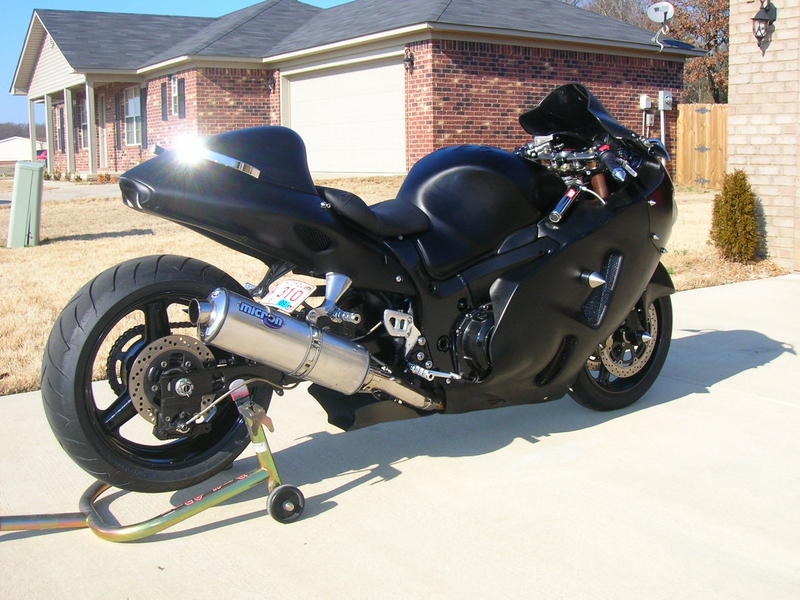

I have a 2002 busa and I dont know whether i want to get a extended swingarm or if i want to get the extentions and put them on it. Can someone post some pics of a couple of busas with extentions on them. Thanks

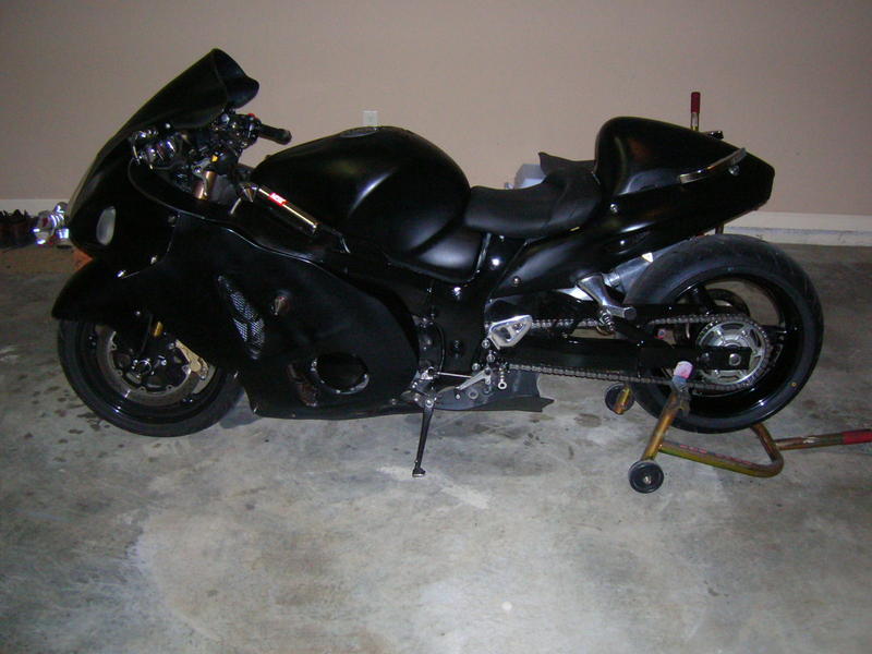

These are photos of my '07 when I had 4-6" extensions on. They were a breeze to put on. I would recommend going with a extended swingarm instead though.

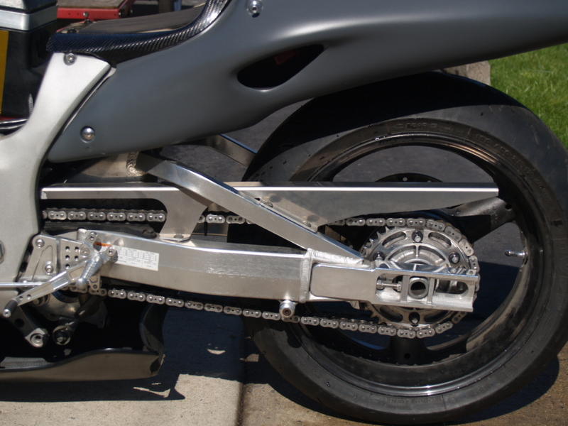

You know, we mountain twisty and track riders need to realize that there is more than one path to take when modifying their Busas. I used to say things like, "why would you do that?" The fact is, extended Busas look good, some areas of our country don't have the mountain environment, some people like to "do the stretch cruise" in urban environments, on and on....it's all good! I have a 0-6" arm for drag racing, comfy touring and LSR. It pretty much stays at 0" extended but so what? Whatever one likes!

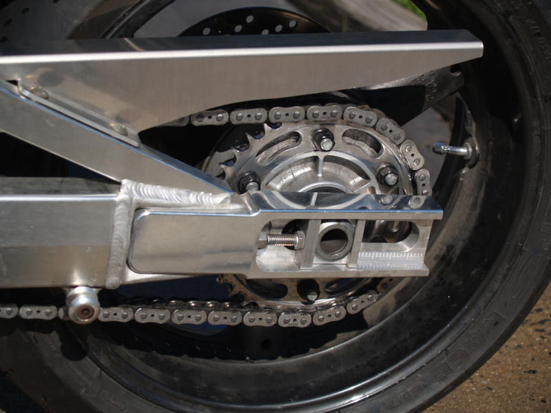

The one thing I would say is GENERALLY SPEAKING, an extended arm (or welded in extensions) in engineering terms...is much perferred over bolt ons. The farther out the arm extends, the more you are asking of the end pieces AND the chain.
Respectfully, Raydog
Very True, that looks nice i want to weld mine on, did you do that yourself? I have the bolt on's and i agree if you could get an extended swingarm, do that, the bolt ons are a cheap way out, consider getting them welded, but make sure the person doing it knows what they are doing, or you take a chance of the weld breaking and looking like CRAP!!!! Nice job RAYDOG:bowdown::thumbsup:
