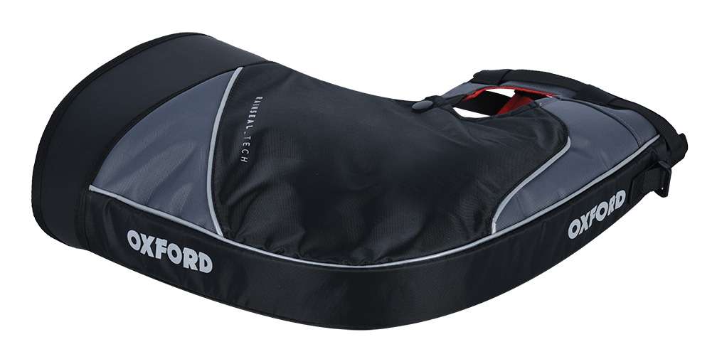

The moto police here use these large muffs in the winter that go completely over the grips and partway up the arm. They look warm and dry. May give them a try someday.
