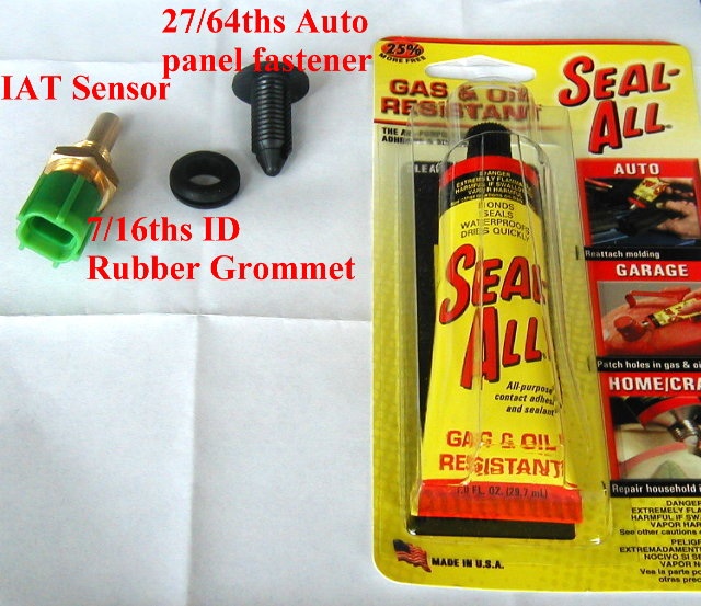

I want to move the sensor on the airbox (screws into airbox and has a green connector. It has to do with the air inlet temp) to the ram air tube. I would like to find an insert that will fit the threads on the sensor. Anyone know where to get such a specific insert?
There's a write up in mods that outlines it. However he used a rubber grommet in a hole drilled into the air duct.
Yup, I read that earlier today. But I can't see any of the pics so I'm not quite sure what is happening

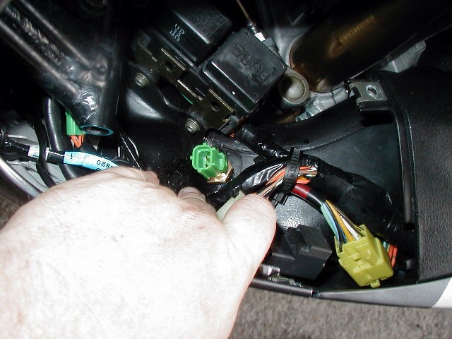

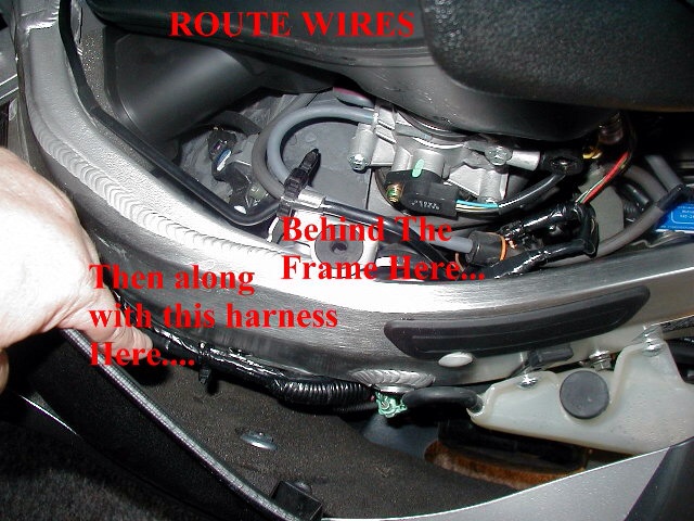

He drilled a 9/16" hole in the top of the left ram air tube. Installed a 7/16" rubber grommet. Pulled the IATS from the air box cut the wires pushed the sensor into the grommet then spliced the wires. It's recommended to make sure you seal the splices so the wires cannot make contact with anything metal. Then he used a plastic push rivet with a cement to fill in the hole in the air box.
