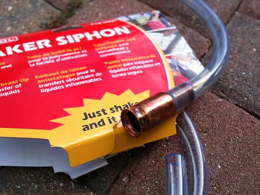

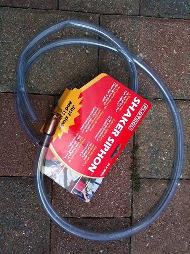

Use one of these. Sold at Pep Boys.
'Shaker Syphon'
Hose with a metal end. Inside end is a captured little ball .
Insert and jiggle. When I was there and the guy was telling me about it I was like yeah right.
Thought I would be back in ten pissed.
If I had not seen it and used it I would not believe it.
The metal has added benefit of allowing you to hear how far down in tank it is .
Stick it in there and wiggle a bit you can hear it on the inside of tank.
This thing sucked ALL 5 GALLONS OUT IN LESS THAN A MINUTE !

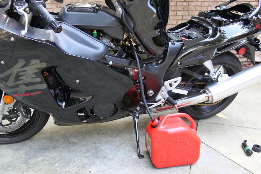

1. Siphon the bulk of bad gas from the tank. There are several ways to do it as covered in previous posts. I decided to purchase and use the Flotool "Shaker Siphon", Part # 10801, available for about $15 at Pep Boys. After siphoning as much as possible, bad gas will remain in the fuel pump and a small amount will remain in the bottom of the tank.
2. Remove the bad gas from the fuel pump and the small amount of bad gas remaining in the bottom of the tank. Do this by making use of the fuel pump in operation itself. Follow these steps:
a. Remove the seats.
b. Remove the two bolts at the top front of the fuel tank and prop up the front end of the fuel tank using the prop rod contained in the tool compartment under the passenger seat.

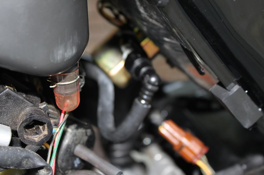

c. At the bottom of the tank, locate the attached fuel pump and where the bike's fuel hose connects to it.
d. Disconnect the fuel hose from the fuel pump by pinching the white plastic connector on both sides and pulling the fuel hose off the male-end metal tube extending from the fuel pump.

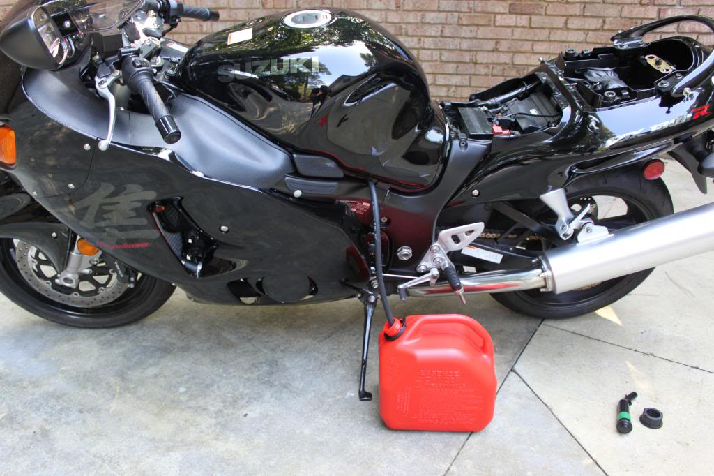

e. Connect a two-feet section of fuel hose to the male-end metal tube from the fuel pump. I used a spare piece of 5/16" (7.9mm) fuel injection hose that I had previously obtained at Pep Boys. The hose fits snug enough to the metal tube to not require additonal fasteners, for the purpose at hand.
f. Put the other end of the fuel hose into a gas container to be used for draining the bad gas.
g. Gently lower the tank. If the weight of the tank pinches the fuel hose too much, place a small block of wood or other material between the tank and frame so that the weight of the tank doesn't pinch the hose. The thickness of the block should only be slightly larger than the diameter of the hose so that the tank can be lowered as much as possible to its normal position.
h. We are now ready to drain (actuallly pump) the bad gas contained contained in the fuel pump as well as the small amount of bad gas remaining in the tank. Set the Ignition Stop Switch on the right handlebar to its OFF position. With the key, turn the ignition ON but do NOT start the engine. Next, press the Ignition Stop Switch to its ON position. The fuel pump will operate for approximately 3 seconds and you should be able to see fuel flowing into the gas container. Cycle the Ignition Stop Switch between its OFF and ON position until all of the bad gas has been pumped into the gas container. On my bike, I had to go through about 15 cycles to empty all of the remaining bad gas.
i. Turn the ignition off with the key.
j. Disconnect the spare fuel hose from the fuel pump and reconnect the bike's fuel hose to the fuel pump. Remove the prop rod and lower the tank, securing its front end with the two bolts.
3. Add at least one gallon of fresh gas, preferably two gallons, to the fuel tank. You should now be able to start the engine and enjoy a ride!
