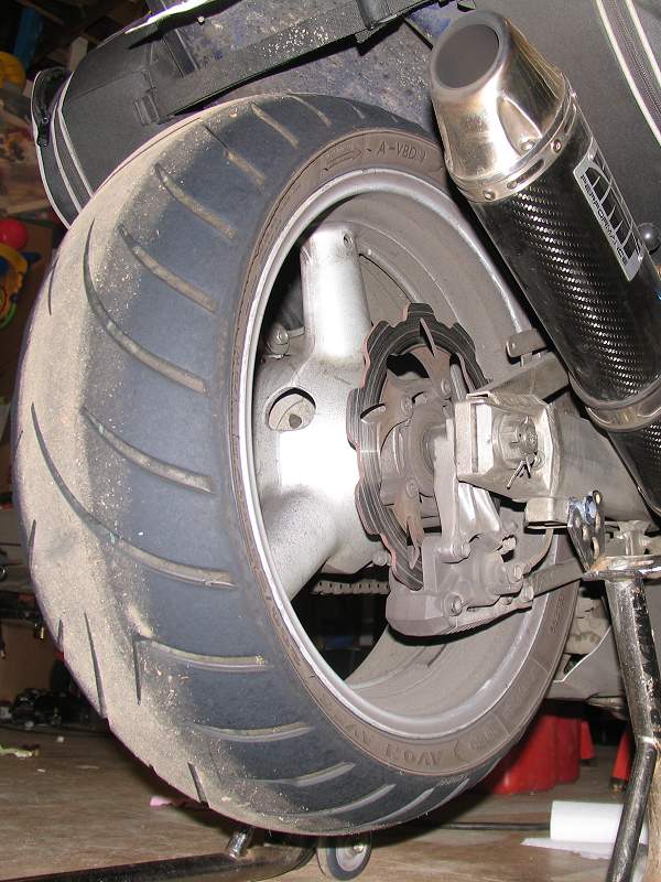

Edit: A picture on the stands..

You need a visual.
Slight problem.

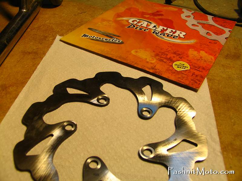

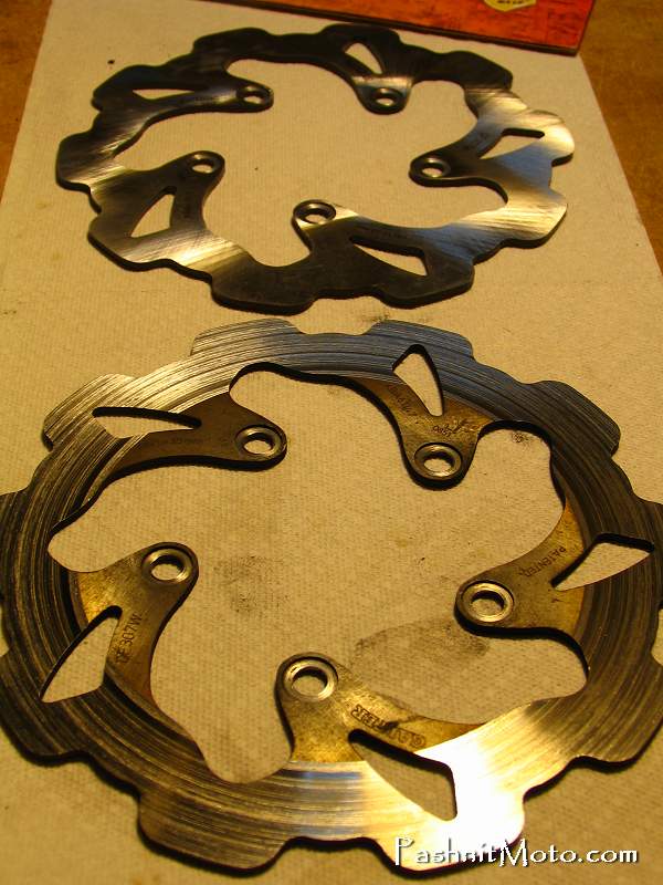

The Solution. :cheerleader:
Take off the old one...
Just put on the new one & done.
