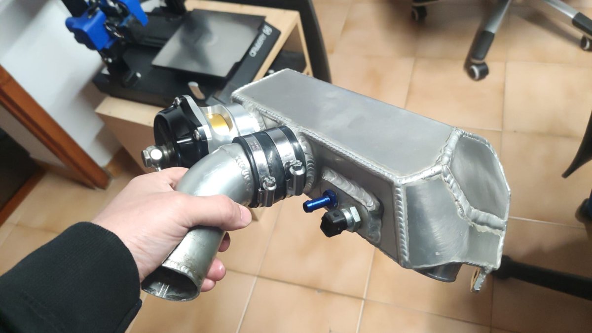

Hello,
I recently bought a kit for my gsxr1000 turbo and I have doubts about installing the water pump, do you have photos of the installation on your bikes?
Another question I have is how do you have it connected to the pump, directly to the battery and by means of a button you turn it on and off or do you control it through a control unit?
My engine is forged 10.1 compression pistons heh, what maximum pressure could I reach with this kit with 98 octane gasoline without danger?
Thanks!
