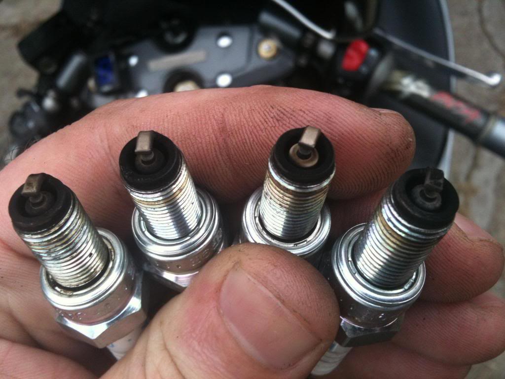

Pulled the plugs today. The picture is taken with the plugs in the same orientation to the cylinders they came out of.
The colours are all over the place... Whats causing this?
Im noticing once exhaust blacker than the other now. Hence the black plug on the right.
This can be caused by a clogged injector. I just went through it. The injector was dropping gas into the cylinder instead of spraying it. The bike hesitated on rev, jumped around while riding but was fine if you got into the throttle. Get a good light over the top of the throttle bodies, turn the ignition on and check the spray. As far as the over heating, letting a busa sit and idle for 30 minutes is like running a drag car on 87 octane. It's just not meant to be. Check your fan and your fluid. Next time put a fan in front of the radiator and try to notice if the gauge rises over half, drops back down and then over heats, or if it over heats immediately.
