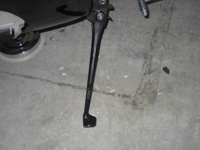

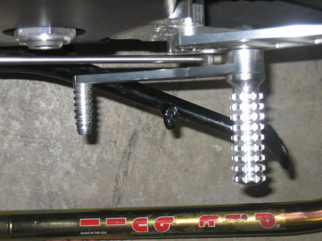

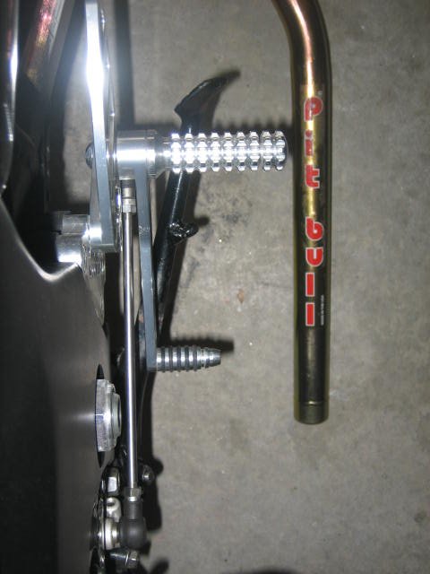

Can't find anything about a kickstand that doesn't block my boot from shifting.
Got vortex rear sets and they're back and down in order for me to be in a relaxed position. I just notice that my boot is being partially blocked from the shift petal.
Anyone know of a solution or better kickstand with pics?

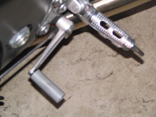

I too, like my shifter lever rather low, in fact I have the same problem with the kickstand. To fix it I extended the lever about an 1.5" or so outward. That way my foot doesn't have to be so close in where the kickstand is. Here is a pic of what I mean. You can use just about anything that will slide snug onto the shaft or get a custom shaft made. One guy even took his shifter and had it turned and tapped (threads added) and screwed on a longer lever.

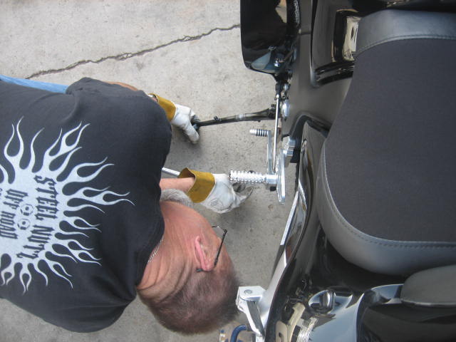

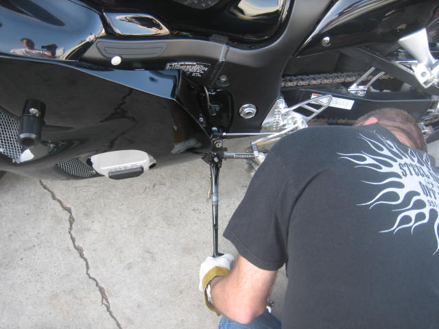

Found a solution! Hired Chuck in Bellflower, CA 562 810-3131 and he cut a gap and hammered it 5-10 degrees back out of the way. This adjustment did stand the bike more upright, so I will need to turn the bars left when parking. But no more slipping on the shifter! Thank Chuck! In addition to this mod. The Vortex guys did recommend slipping o rings around the peg, which did help.
