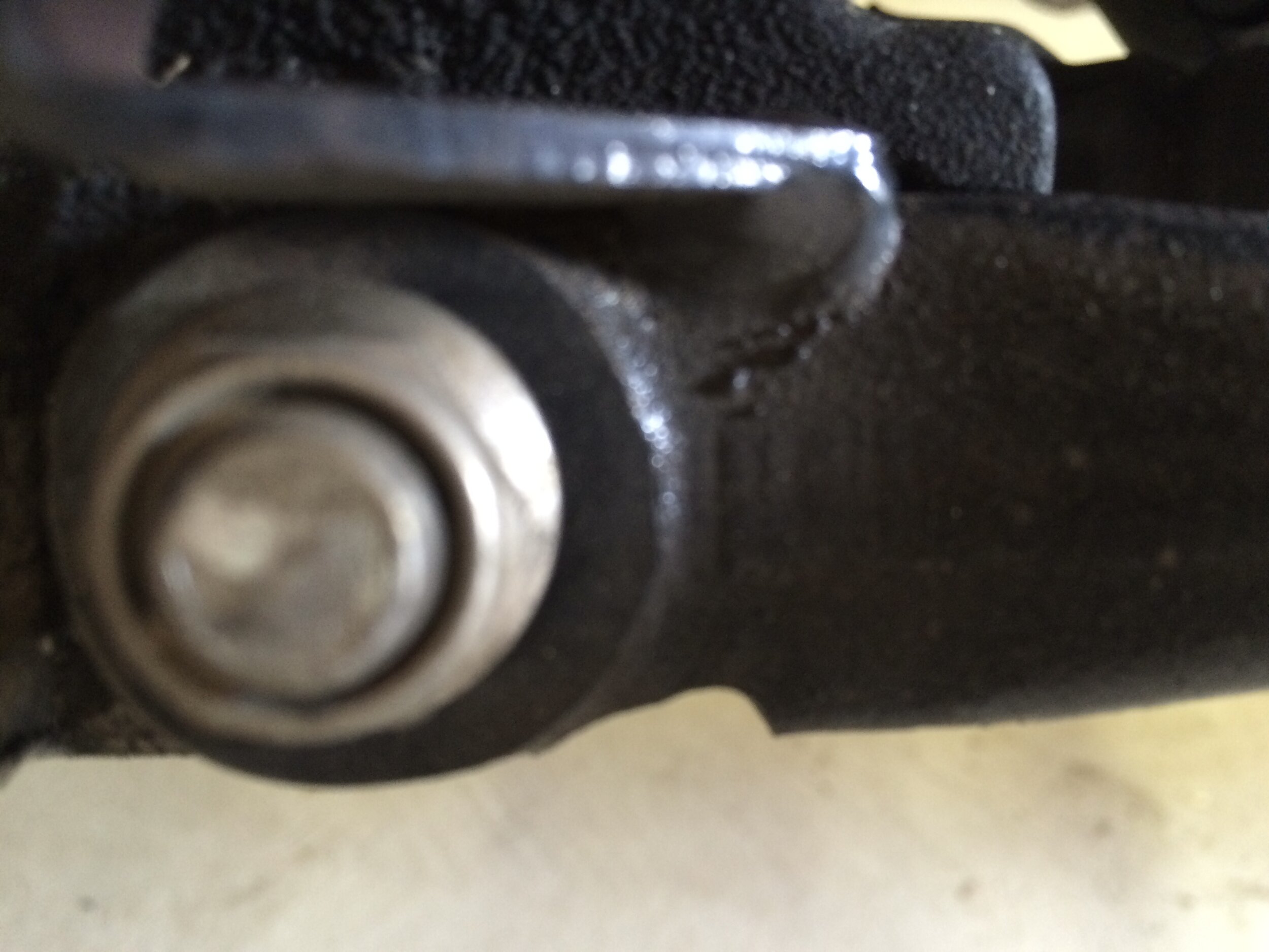

Hey, I remember on my last busa cutting a little out of the stopper forward of the kickstand so it goes further forward, it was recommended since they said the bike tips off the stand easily. I haven't checked it this time around but is that still a typical mod?

lol, yes it's a shocker! Did they do it to sell spare parts? Anyway do you have a pic of the cutout, it was on the stop from memory, just a couple of mm? I'd rather not experiment.
I do not, but Red/ @Rojo posted the link in another thread recently.
I'll see if I can find it, or he may post it here since I tagged him.
And yes, it is only a small amount of material removed, and only takes about a minute with a Dremel or small grinding bit, or you can use a file if need be.

Thanks Red!
Perhaps they would like before & after #KickStandMod done *
leaned over against a sturdy tree ~ then just file away at the notch *
See pashnit's post on this:
