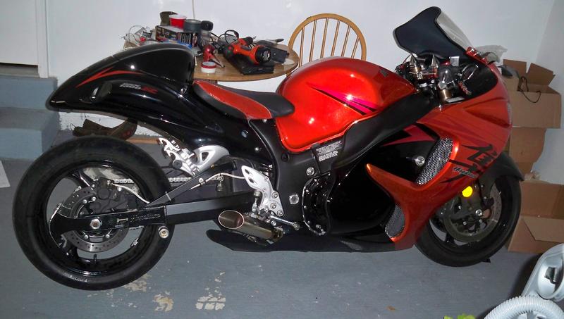

I understand when you strap it your sitting on it so the stock kicker wouldnt be an issue there but my 02" was slammed front and rear 3",stretched 6over,no way would I leave the stock kicker on there,she was pretty much straight up and down, 2" lower wasnt much better,but to each their own,I wasnt taking any chances she would get tipped over
nice swingarm,like the paint:thumbsup:
Ya, mines not SLAMMED until i strap it. I raised the tubes a through the tree about 1.5" and match the rear with a slight rake. I can ride it all over unstrapped(and im 6' 250lbs)and NEVER scrape or rub anything(its stretched about 3.5" also), and the stock kick stand still works good! :thumbsup:
