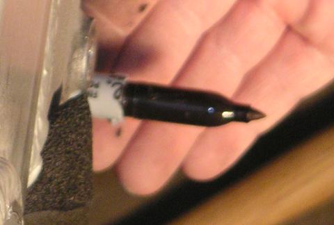

Ok now we need to figure out how to line up the center of our hole. Take a regular Sharpie in any color you choose and grab a pair of pliers. You may want to be outside and not wearing some clothes you want to keep. Pull the cap off and grab onto business end of the Sharpie with the pliers and pull the inside piece of plastic out. Then cut the excess tampon part off.
Should look like this, I tried to use the end of the sharpie but it was too wide:
Now you can take that bolt out of the frame and take a single strip of duct tape and put it about 1 and 1/2 inches from the tip of the Sharpie. Now you just stick the Sharpie in the hole you just took the bolt out of. Now put the fairing back on and screw in the two screws that mount the fairing to the frame. Push in on the fairing just below the top mounting bolt to get your mark on the inside of the fairing.

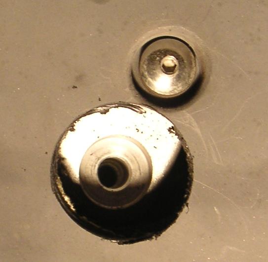

The left should look like this:

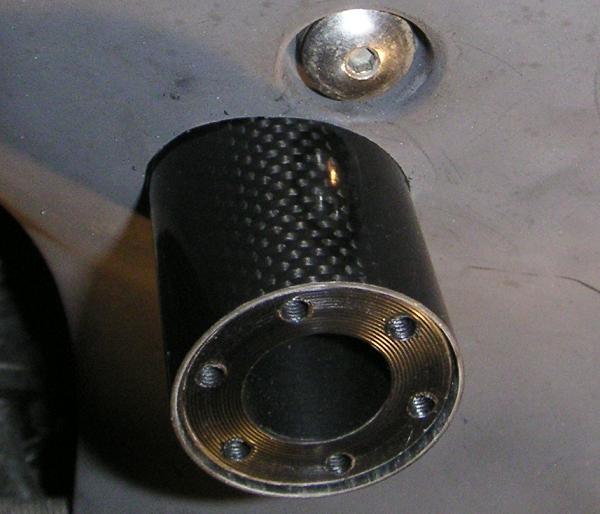

See what I mean about the 1 3/4" Hole saw being perfect? Your hole is going to be a little rough, use a rasp file or sand paper to smooth the edges. Now if you did this right you should be able to mount the frame slider without taking the fariing off again. Slide the slider through the hole and check for tight spots that may be a problem later. Slide the new frame bolt in and start to tighten being sure not to crossthread or force the bolt in. Also check to make sure you didn't pin the fairing behind the slider(I did).
IMPORTANT-- the two frame sliders are not identical in length, there are instructions read them(I didn't at first)
ALSO IMPORTANT -- the new bolts are not the same size either, check the instructions for instruction.

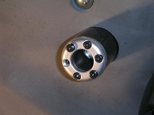

Here is the left side once you are done:
Pretty simple, if I can do it you can do it. Just take your time and double check everything before you make a mistake. Have fun, hope this helps some of you.

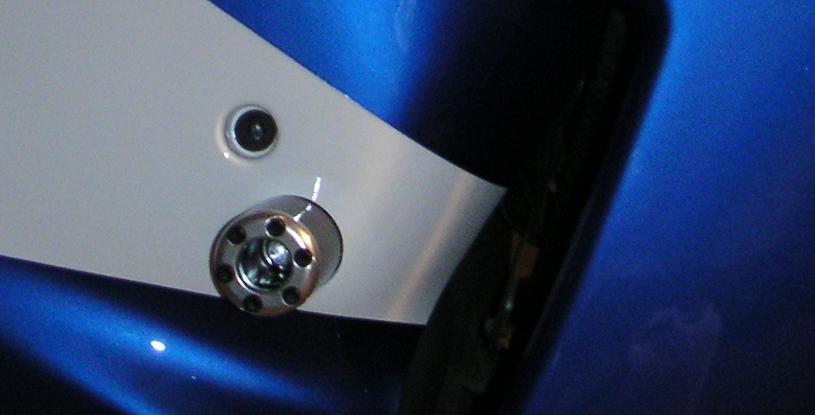

Soon, I just got the parts back from the painter yesterday, should have it back together by Saturday.  So stay tuned for some pics.  Here is a teaser.
