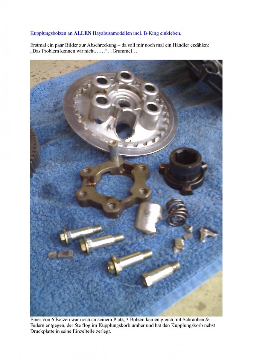

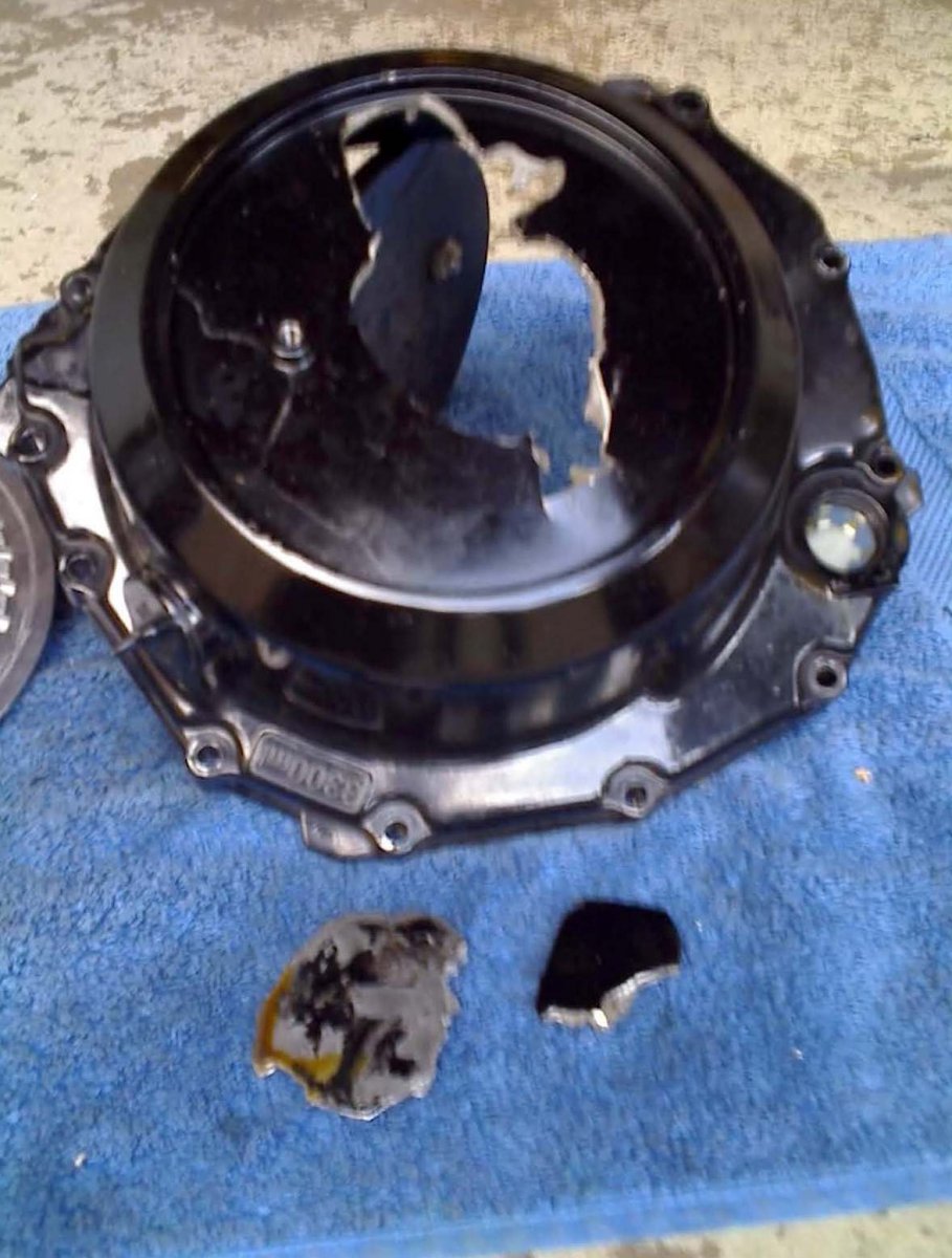

hi @AgSurfer
:welcome: to the .org with ur nice bike . :thumbsup:
but
at very first watch my maintenance schedule in the attachement and follow it line by line
with a big big imperatively view at the clutch´s bolts to avoid what may happen . :banghead:
NO matter if gen1 or gen2 - this issue is the same at both !
even suzuki described that need (imperatively) in both manuals they did NOT glue in the bolts in japan while the clutch was built in up to the latest gen2 model .
what they did was to send a bulletin for ´08 & ´09 to the dealers but suzuki ignored all experiances "from the field" at all busa - ´99 - ´20 !!!!!!

any other questions / requests ?
guess no.
the view if happened
