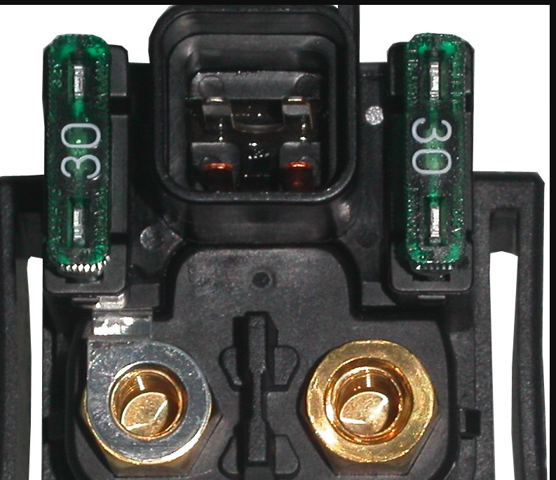

My 2006 Busa was working fine until I switched the front fairing. I was about to turn it on when I inserted my key and it gave me absolutely nothing, not even ignition or the lights coming on or anything. I have no idea what's wrong with it. The picture I uploaded is a connector That's from the headlight wiring harness that I have no idea where it goes and I thought that was the problem. Can someone please help me!View media item 101752
Check your fuse under the seat this connector for accessories leave it see the attached photo
On the left side of your bike there is a white connector that feeds to everything in the nose. Make sure that you have reconnected that and it is seated. Yes, check the fuses - that extra connector is for markets outside of the US, there is nothing plugged into it - most people use that to tap into power for accessories the install in their cockpit.
thank you so much for your help. Yeah I definitely of which connector you're talking about, i connected it but it's good advice I do need to check to see if it's properly seated, what really confuses me about this problem is that I changed everything on the bike from the turn signals to almost everything short of giving it brand new lines and the last thing I was doing was changing for a brand new fairing I had just bought. one of the last things I had left to do was change the nose and my bike was working perfectly up to that point and then I changed it and when I was about to turn it on because I was extremely excited that I was finally over, after 2 months in my garage and and an insane amount of money I go to turn it on and when I put the ignition absolutely nothing comes on, no lights on dash and no headlights no blinkers, no horn and it makes absolutely no sense on what could have gone wrong from that but thank you I would take any advice and help I can get right. I already checked the switches and the relay and so far they seem ok. Thank you I will try this when I get home.
Thank you so much for your help I have to check those fuses, I took a quick glance before I left and I didn't see it right away when I removed my seat but I'll check and take my time as soon as I get out of work. Thank you so much for your help, I'm completely out of ideas so I'll do whatever it takes. Thank you.
Also check and make sure harness for gages didnt come unplugged in all the mayhem.
