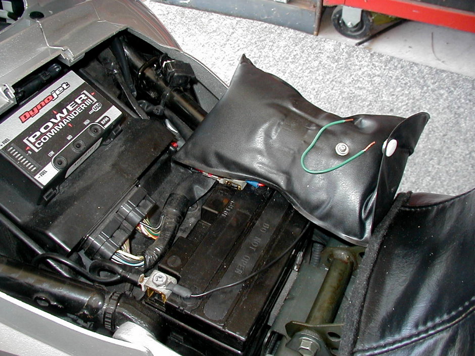

As an Automotive tech with GM we would do a dealer approved TAP test on the ECM or in this case the ECU. Simply have it running and slap the ECU with your open hand to see if the bike hiccups or runs any differently. Use some restraint, you don't need to take out your frustration on the bike....at least not yet. Wait until you get it running properly, then you can beat on it the right way!

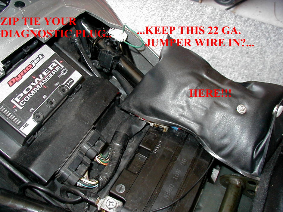

Jinkster to the rescue...try this for starters...
getcher self "wired"...
then jump the diagnostics plug...
then?..turn the ign. key to the on position and?...
read, record and translate any error codes that pop up on your lcd...
this will diagnose and "rule-in/rule-out' any possible sensor or fi issues.
L8R, Bill. :cool:

I will try this soon as I can get back to the bike. Thanks for the help and for the sych write up as it was yours that I used!

Well you where right C 00 no codes. You really think a bike that just rolled 11k needs the valves adjusted? Yes its hard to start but it always fires its just that it stalls or idles very low. On high idle it will idle at 1100-1200 rpms and at that point if you get on it and try to ride it then what happens is you take off, the bike bogs down and is very jerky so of course you twist the gas alittle more then BAM! rear tire up in smoke front wheel up in the air. but untill you stop and and shut it on and off again and again with the high idle on untill it starts and idles at 3k with the high idle the thing is jerky and almost unridable below 6k rpms (I only use the high idle as a gauge to more easily tell when its at that point that its running right)
