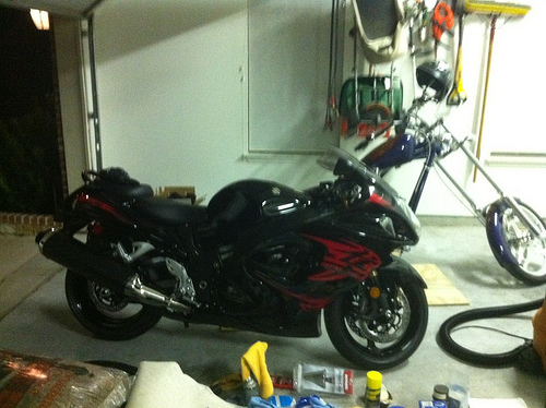

Anyway, I took a break from bikes and came back onto the scene with a 2011 Black/Red Hayabusa. Already slapped on a BMC street, Akrapovic evo 4-2-1, SS lines, Puig DB, tank bra, spools, alarm.

Photos are here: Flickr: Dolent's Photostream
A couple of before and afters:
