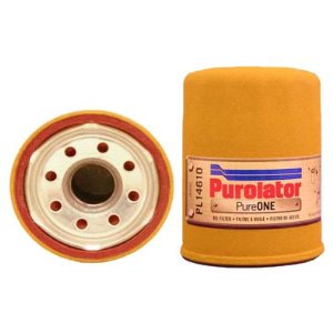

http://www.amazon.com/dp/B000GIVEII/?tag=hayabusamazon-20
Thinking of this filter, have not decided on oil yet.
Anyone try this filter?
