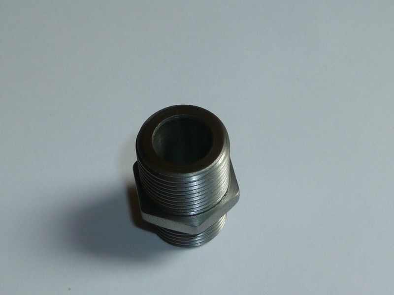

I now have the parts and was planning on making a thorough post when I got the chance to install them. Running through the numbers, the parts cost $20 total with filter, so I'll break even at the second oil change with $5 filters from then on.
The filter adapter from Bales Tech looks like a very nice part. Shipping was superquick - like two days! - as fast as Amazon Prime shipping for the filter.
The first two pics show the adapter. The left side threads are the M20 x 1.5 threaded part that fits the new oil filter. The stock Suzuki filter uses a M20 x 1 thread, which is essentially the same diameter, but a coarser thread (fewer threads per mm).
Haven't measured the thread on the other end. Given that it is smaller (the side that screws into the engine), that determines the max safe bore of the adapter. I plan to compare the stock part and the Bales Tech adapter to verify that the bores are the same, as this could potentially restrict fluid flow. Right now, I'm not worried.
I went with a different filter than the one recommended by Mark Lawrence on his filter comparison page: Motorcycle Oil Filter Comparison. Mark recommends the Purolator PL14610 filter. Many people talk about using this filter on the Kawi and Honda forums. There are two things I did not like about this filter for the Hayabusa application: 1) It is longer than the stock Busa filter (3.52" vs. 2.5" tall) and I am concerned about clearance; and 2) It has a significantly higher pressure for opening the bypass valve compared to the stock filter. Of these, the bypass pressure was the biggest concern.
I ended up buying the Purolator PureONE PL14459 filter. This is shorter, just a little taller than the stock filter (2.95" vs. 2.5" tall). It is also fatter than the PL14610 (3.15" OD vs. 2.69"). The fatter can allows more filter material, but the base gasket is the same dimension). The PL14459 has a relief pressure of 12 to 15 psi (stock is 11 psi), vs. the PL14610 which is 14 - 18 psi. I think this difference is important because these engines pump a lot of fluid at peak rpm and I did not want the filter choking oil flow before the bypass valve opens.
That's it for now. I'm not too worried about the installation per the OP WheelinAZ's post. If I have to, I can use a half-inch drive with a long bar to break it loose. I'll take pics and post when I do the surgery.
PS - You can also put a few drops of acetone on the threads to help break the loctite. I really don't think this is a problem, but should know soon. :)

Ok, started doing this job tonight. Replacing the adapter is not all that difficult, although you will destroy your original / stock adapter doing it.
HOWEVER, I am recommending against this mod, even if it seems I am stuck with it. :(
The PL14459 filter I picked would fit *IF* the fatter can could get in there past the exhaust pipes and the small oil line that is in the front, and unfortunately in the way. The can is just too fat to fit through the space.
