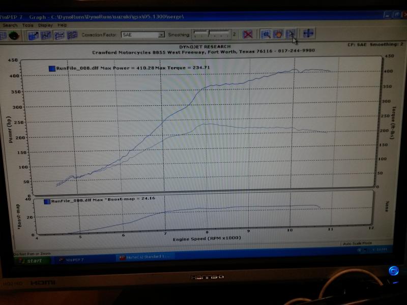

While you are right about the craziness of the asking price for a boosted motor only, you arent right on the boost levels.
400@20 is good.
otherwise you are saying MR2's build sucks with 410@24 psi
I think a lot of that depends on the size of the turbo. Brett has a gt40, his needs way less PSI to make the same HP that my gt30 does.
