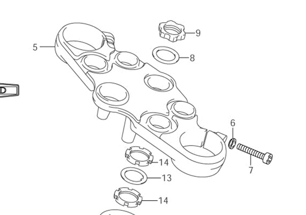

This is the "tripple tree" you ordered...right?
Remove four plugs (#6) and four bolts (#7) to remove the triple tree cover.

This is the upper fork tube clamp...also a triple tree.
Loosen two bolts (#7) to release the fork tubes.

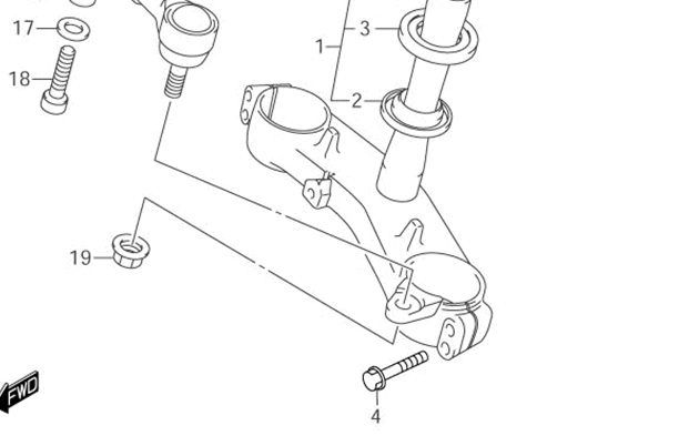

This is the lower one.
Loosen four bolts (#4) to release the fork tubes. The front may drop on you, so just loosen these a little at a time so it is controlable.
