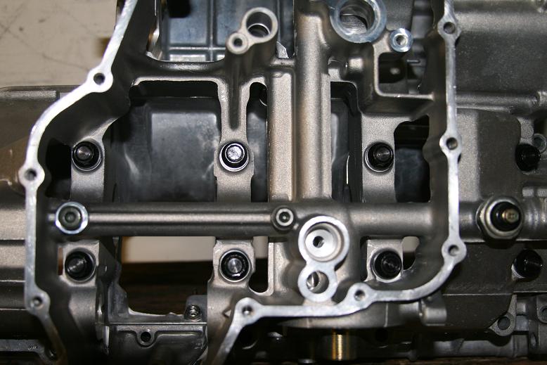

I have the billet shift shafts ordered so that when my tranny comes back those along with some other odds and ends will come too. As for the lower end studs I was not thinking I would be putting too much stress on the block to need them. But I will definately look into them. I dont think they are very expensive so maybe I will just get them for more insurance lol.
