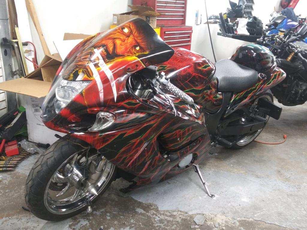

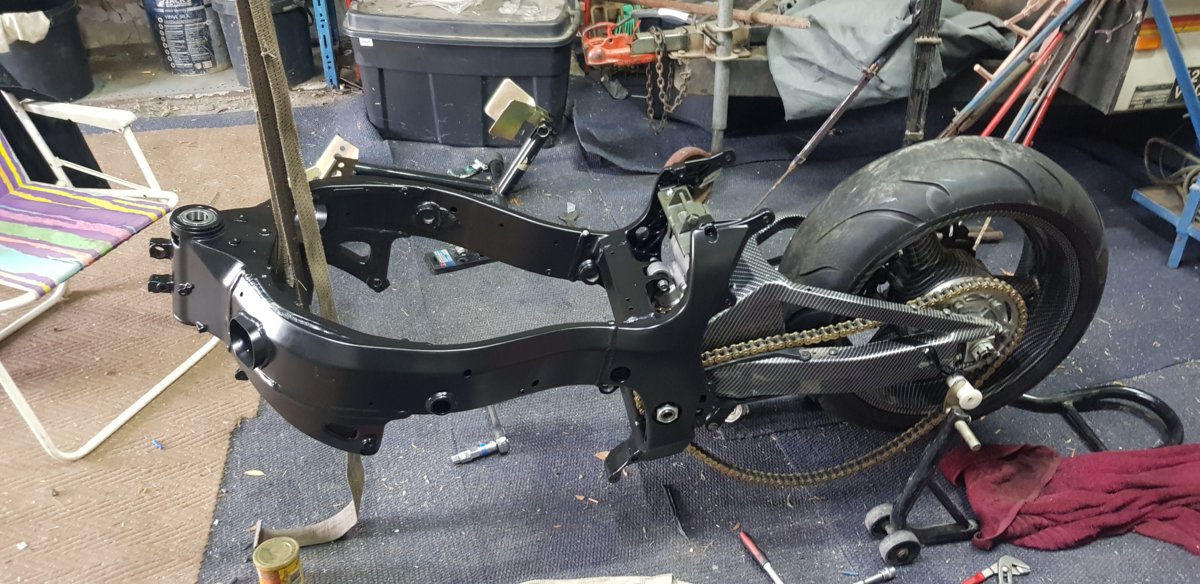

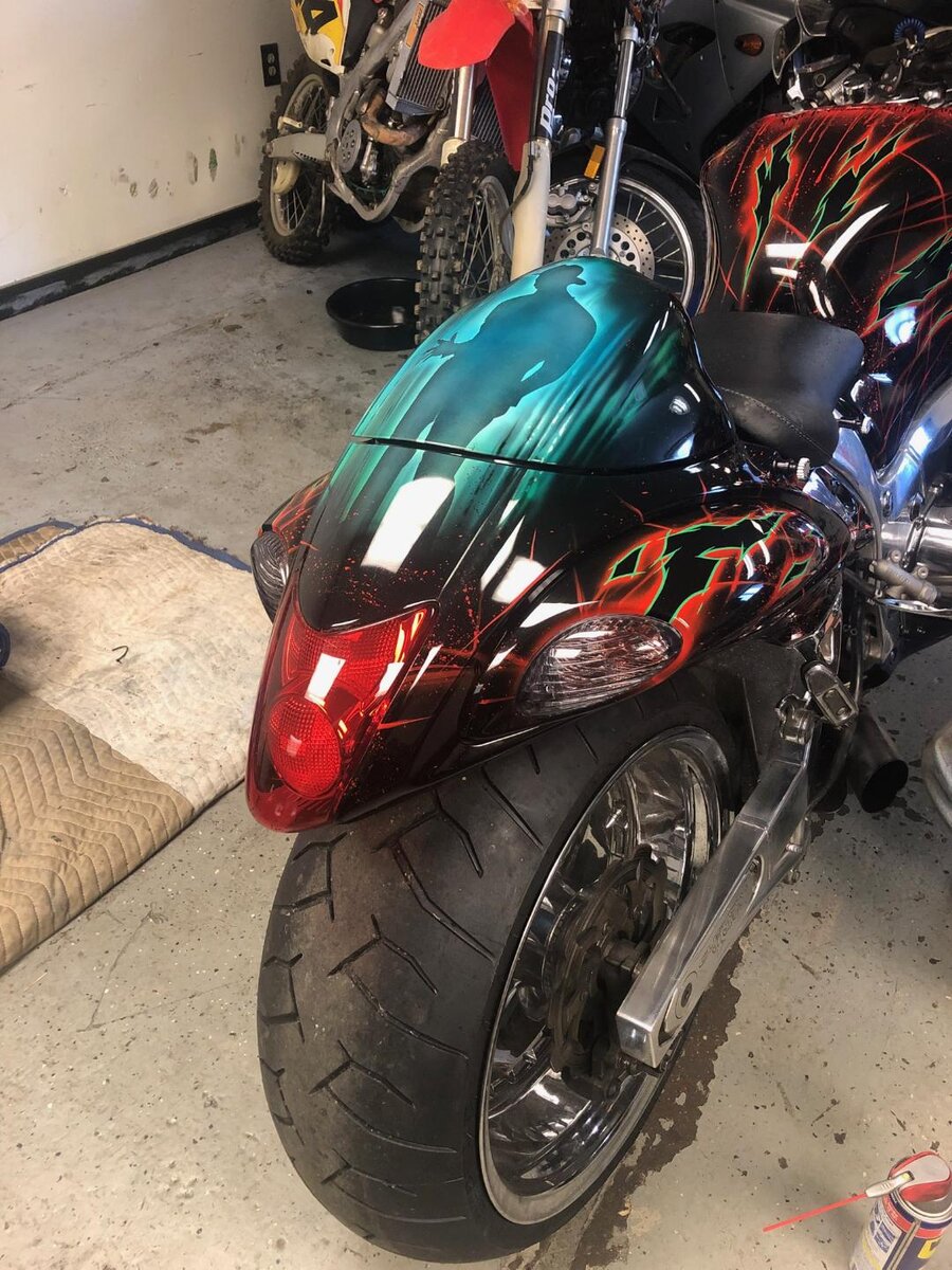

i attach few pics of before i started and busy with. Just for the fun of it.

Is that paint or a wrap on the swing arm & wheels? Neat look.
Wow! quite the project you have going on there . . .
Is that a Gen 2 being converted to a Gen 1 look alike?
I take my hat off to you mate, that's quite an involved job to do . .as you well know.
I'm sorry but can't help you re keeping the Gen 21 clocks on it, but aren't you using the Gen 2 harness? I mean, that engine is Gen 2 or Gen 1?
Looks like Gen 1 throttle bodies but Gen 2 radiator . . . beats me, a real mix up, but will end up very unique and awesome too!

Hi buddy, its a gen 1 thats been converted to Gen 2 , yes it is gen 1 throttle bodies but thats not a big issue on that one. that is sorted for now LOL. Yes this is a project that i need to finish, not easy but getting there step by step.
my whole plan on this one is toe make it more gen2 look alike but gen 1 motor still. thats why all the other parts is converted to gen 2.
