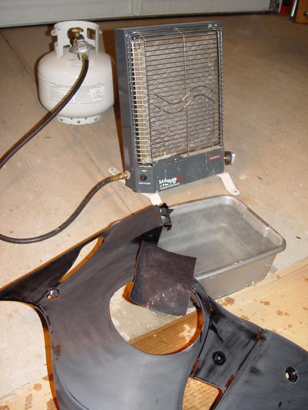

I used both 800 grit and 320 grit wet sandpaper, a bucket of hot water because it is in the 40's outside, a catalytic heater in the garage, 2 part plastic cement, and a glazing putty that is flexible...

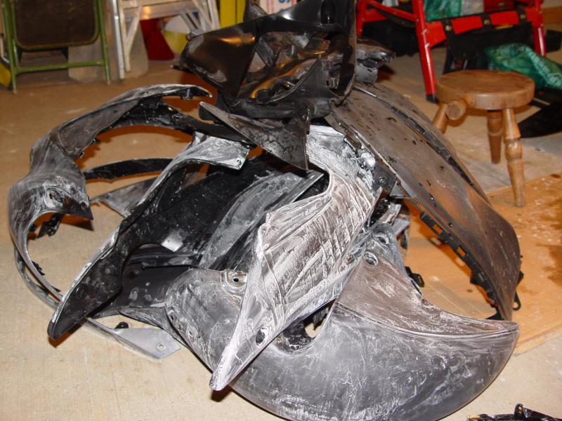

First thing is to use the 320 grit to sand down the grooved areas. You just want to rough up the general areas and take the burrs on the edges of the grooved plastic down to level. U are not trying to remove the grooves... You can see by one of the pictures what scuffed up plastic looks like and what areas were missed (glossy) and need more attention
