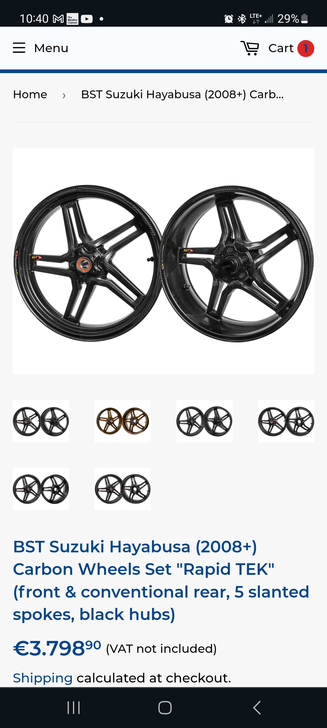

About to pull the trigger on these soon? Thoughts?
Hi. They look nice. How are the roads where you live? Some people have had good luck with CF wheels and some have not. I have talked to DME about CF wheel they told me thst they have broken them. They are not on my bike and never will be. I have Marvic 17x3.5 front and 17x6.75 on the rear. I am getting ready to paint it
If you are happy with your local ride road conditions , and not looking at massive power application , the carbon wheel will be fine , with due care .
I believe incidents can occur with big power , Like @michael parris heuberger mentions , DME have experienced cases of failure , but are they talking road incidents and or 600bhp+ bikes like Mikes build ? I see Mike is running what looks to me to be a aluminum rear rotor.... also would not be recommended for street .
I think if your plan is still the same as you originally envisioned and mentioned , the wheels will cope well with that power level , and your bike will be on the way to being that rare very special build , that also handles well .
From everyone I've talked to its a big improvement that's worth it if you can afford it
It is another step towards the best handling Busa you can put together . Sure , you will need to look at other areas like suspension upgrade etc., to make it that bike I am thinking your after . It all depends on what you want for your bikes ride .

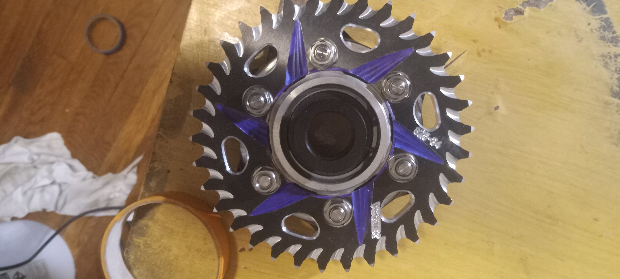

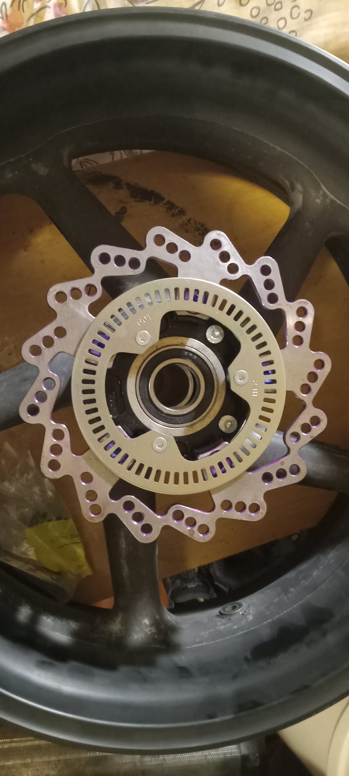

Hi. Yes DME has 600 to 800 + HP bikes they have also ran in to the 5sec 1/4 mile like Chris Moor has and Willaford have. As you all know street legal no bar bikes. And no that is a steel rotor I do have an aluminum also Eric mabe up the mount for the speed sensor so I now will have front wheel and rear wheel spedos. Tjat is so I will know how fast the rear wheel is spinning compaired to the front and no I do not want a 150 or 200 or a 250MPH wheelie. Erick when he went 264 MPH his rear weel speed was 310 that is why my gearing is for 315 to 320.
Well , that is a great rear disc then , nice job on the cut out , so still very light by the looks . Well , we know from those race masters that carbon is not for heavy HP , and not perhaps best for bad road conditions , but I risk it with medium power maybe , and still a bit chit roads.
