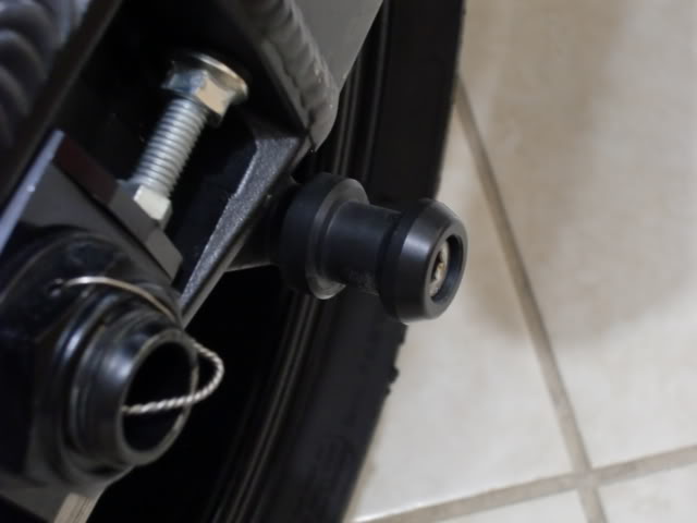

And a pic of the spools I use..
The hooks slide in and out and you should make it in someway able to be adjusted for any margin of error.
